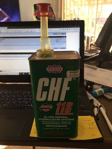

It is important to only use the correct fluid, Which is pentosin CHF 11S. You can get it from Car Quest, Amazon, etc.
Do not ever mix with others!

Thanks for the responses. Fluid level is between the cap marks and is 11s. I'm almost certain it is not the PS pump. I can hear the pump when the car is running, at idle, and I turn the steering left and right. Not a loud noise and it get a bit louder (not much) when turning the wheel stationary. Also, if I press the accelerator a bit and raise the idle (car still stationary), and turn left and right, the PS pump sound is the same as the previous scenario. However, if in gear and moving, I can hear an rpm-dependent sound, only when turning and accelerating at the same time. If I'm coasting (off the gas) and turn, no noise; if I accelerate while turning, I can hear the noise. Almost like a belt noise, but the pump is electric.
