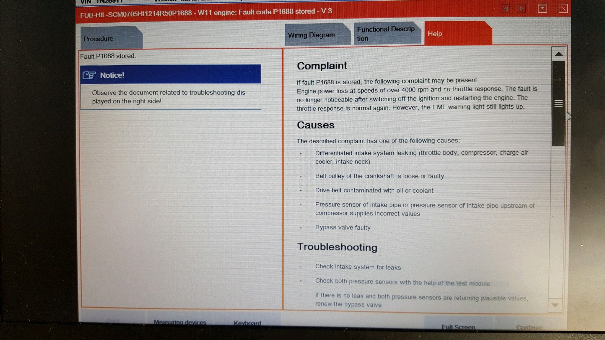

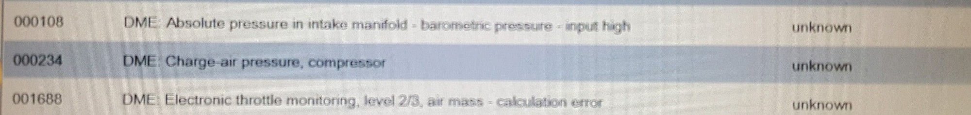

Yes, the car is in now in limp mode. What initially started as a "replace the gas cap" has now escalated to the fault codes you see below. I did some routine maintenance on my DDM cai, and over-oiled the filter. I fixed the mistake, but not sure if oil went through the intake system. We pulled the SC, and it showed no signs of oil. After correcting this the car took on an incredible 'deep sound'; nothing that I've heard before. Just before my car lost all power and did the limp mode, The SC took on an exponentially LOUDER whine as if on steroids! From the Youtube vids I've seen, it is NOT the death rattle. Checked the sc boots for leaks, for any detached hoses, and haven't found anything. Has anyone else dealt with this? Oh yeah, the car has 106k on it.
These are the codes:
The fault codes
Recommendation(s)

This was a P0108 to start with and yesterday after removing/reinstalling the intercooler it was on the way back from my house that the limp mode occurred. Today when have I checked had the 0238 and the 1688. When Vmaxx started the car up yesterday the supercharger was really loud, so loud that I almost jumped back from the car. Could be two issues, a bad tmap and a supercharger issue. A loose belt and the supercharger might not spin as much but the thing was really loud at 1000 rpms.
