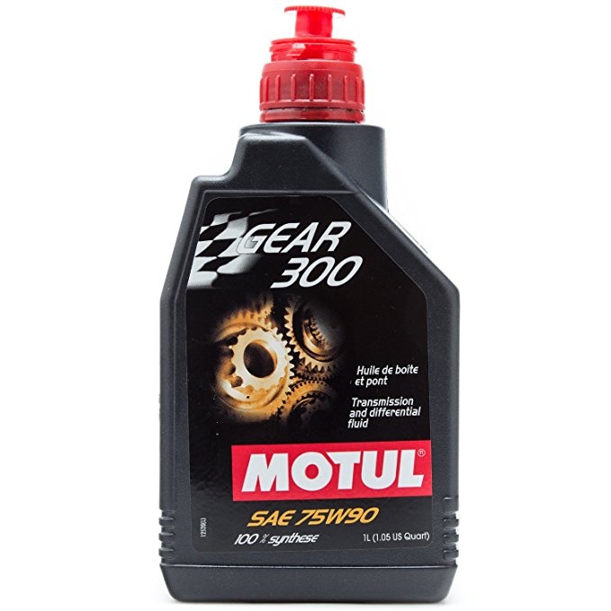

I agree with the guys above. Get a trans fluid flush first.
Motul Gear300 75w90 Synthetic, is excellent trans fluid. You can by it by the bottle on Amazon.

In this instance, that is not the correct fluid. Since the OP has an automatic transmission, a JWS 3309 compatible fluid is needed. There are multiple threads on fluids that people recommend, Toyota T-IV, Royal Purple MaxATF, among others.
