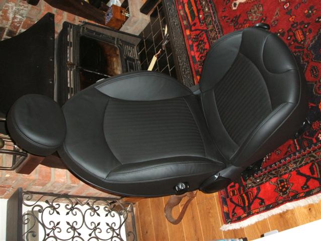

new in here, im trying to put airbags from 03 seats into 07 punced leather ones. then 07 seats into 03 mini abit of moding.i know but im going t do it one way or another. but first id like t know how t take out the 03 seats ,and does anyone know if the airbags on them are likely to fit in the holes on the 07 seats,...........leave it at that f the moment till the ball gets rolling.cheers.

I dont suppose you have any pics of a stripped 03 seat or airbag by any chance, as ive started stripping the 07 seat to get an idear of whats to come
but cant remove 03 seats till i know the right way t do it mself.

To remove an 03 seat, simply remove four Torx bolts at the rails.
Before you dismantle the seats, I suggest you compare the connectors under the new and old seats. If they are all the same, there is a chance you may be able to just plug it in and it might be compatible. I wouldn't know how to verify though (except the obvious way
By the way, it is not just the airbag you need to be concerned about compatibility, but also the seatbeat tensioner.
).By the way, it is not just the airbag you need to be concerned about compatibility, but also the seatbeat tensioner.
RKW,,cheers chap, tensioners look the same mount, i want to keep the 03 tsnrs, and airbags,,,an put them in the 07 seats,no probs with conectors then! but ide like t know if 03-07 airbag sizes are similar,,,i dont want t take out 03 seats untill im sure cos i still need t use it so i'll
only have a day t do it?

That's why I suggested comparing the harness connectors under the seat. I didn't expect the airbags to be the same part, but maybe they are triggered by the same electrical signal. There is a chance that you can simply install the new seat and plug in the connectors.
The plugs are diferent on the 07 seat and also the pas, seat has load sensor,
which is why i want to put the 03 bags in the 07 seats so i dont have to recode or change plugs
.has anyone striped a 1st gen seat ,,any pics?
