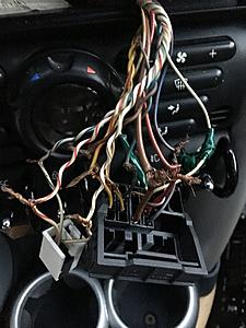

Bought my wife her first mini yesterday 2004. She has been after me for a long time. Got a deal on it (1200.) due to the fact that it did not start. The young man that told me that it needed ECU, he said that after installing a aftermarket radio the car would not start.(pic of harness he cut up)
Checked all fuses F5 has no power and the pic on the back of the panel looks like guadeg'es but searching the old inter-web some one said its starter (don't think so) another says ac fans? So I repaired the harness that he hacked up ( sodering and shrink tube) and re installed the factory radio. Then reset the ECU using test 21. Still wont start.going to check neutral safety switch tonight, and see about jumping starter to see if starter is good. was looking into ECU being bad found a place in Fl 375.00 to repair ECU if it comes to that. Any ideas would be welcomed something i didn't think of.

I absolutely hate when people butcher in aftermarket radios! Sheesh, this person had no clue, when he "modded the wiring harness!"
Keep us posted on your progress and what it took to fix it!
He may have shorted something in the ecu, sadly, that can be a PITA to get worked out!
Re-programing the ecu is a tricky operation, that has no area for mistakes and requires a 90 amp battery charger and a rock solid internet line, with dealer quality programming tool.
There are a few reputable companies doing that.

I would check ALL your fuses. That is the worst wire job I’ve ever seen... does it even try to turn over? Any signs of life from anything?

My God did he butcher those wires
