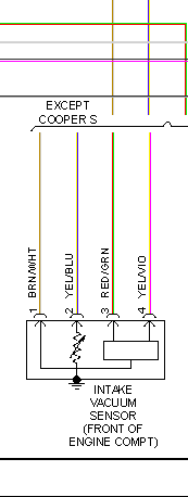

Need help with this diagnosis code. Look like the R50 doesn't have a IAT sensor but yet have a wiring scheme that goes to the "front engine compartment". Do anyone knows where the Intake Vacuum Sensor is located? I'm thinking there is a short and throwing a code.

If your car has not been messed with by amateur mechanics like me, the chance of hoping it is a simple short is next to nil. R50 does has a MAPT sensor as I read. It is for pressure and temp.

TMAP, yes I read about it but i have replaced 2 TMAP sensor and still the code is still present. Trying to fish the wires to make sure it might be cross. Dealer told me it was a faulty DME and wanted to charge 2K+ for parts and labor. Just making sure I am looking in the right direction. Thanks pnwR53S
