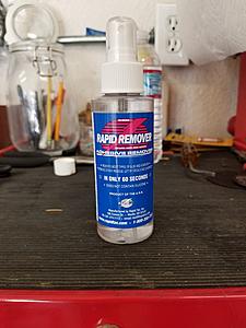

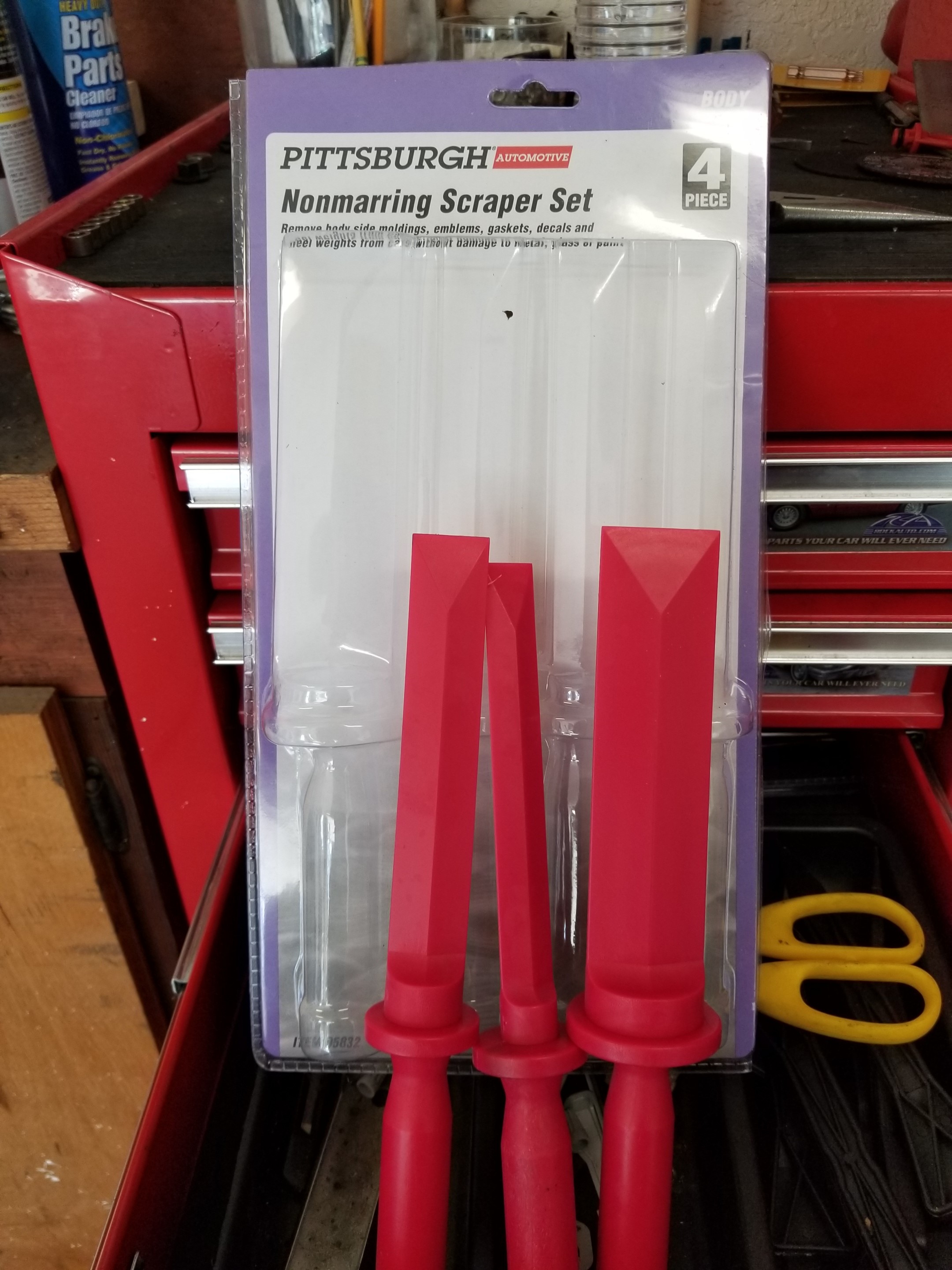

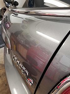

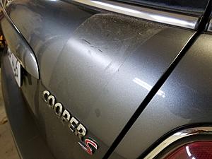

Results
I found a combination of items that solved my problem! The spray chemical is called Rapid Remover Adhesive Remover and I found it on Amazon. $10.29 for the bottle. Also went to Harbor Freight and picked up some plastic non-marring scrapers for $12.99. At first I used it on the driver side stripe I had been working on with all those other products that I had been trying out. Thought I might have given the remover a head start and loosened up some adhesive. But, when I moved to and untouched stripe, this is where the remover did it thing! It took a couple of passes, but when all is said and done, It did its thing. If I chose to remove the hoods stripe I still have the option of the eraser wheel or pull the vinyl and use the adhesive remover again. I think it would be pull vinyl and use remover. Even though i have never used the eraser wheel, it seems a little harsh and the chances for burning paint is greater.

Glad it worked!
It looks like it is Citrus Peel Oils and other assorted chemicals. They threw the kitchen sink of solutions into that bottle. Hopefully I'll remember this thread when I need to do this.
