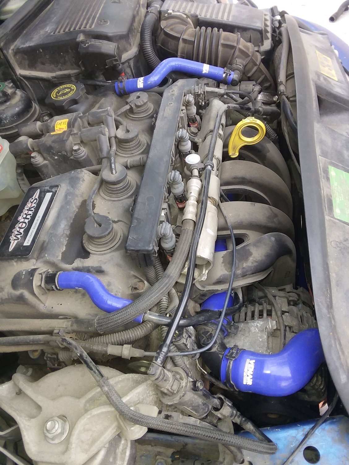

Installed the OutMotoring hose kit today. 2 of the 5 hoses weren't even for the cooling system, they were for the vacuum system. Kit was missing hose to overflow reservoir and all of the heater core hoses, which, as it turned out, were the ones most in need of replacement. A ton of work to install, took us nearly 5 hours, including time spent to fetch missing hoses.
