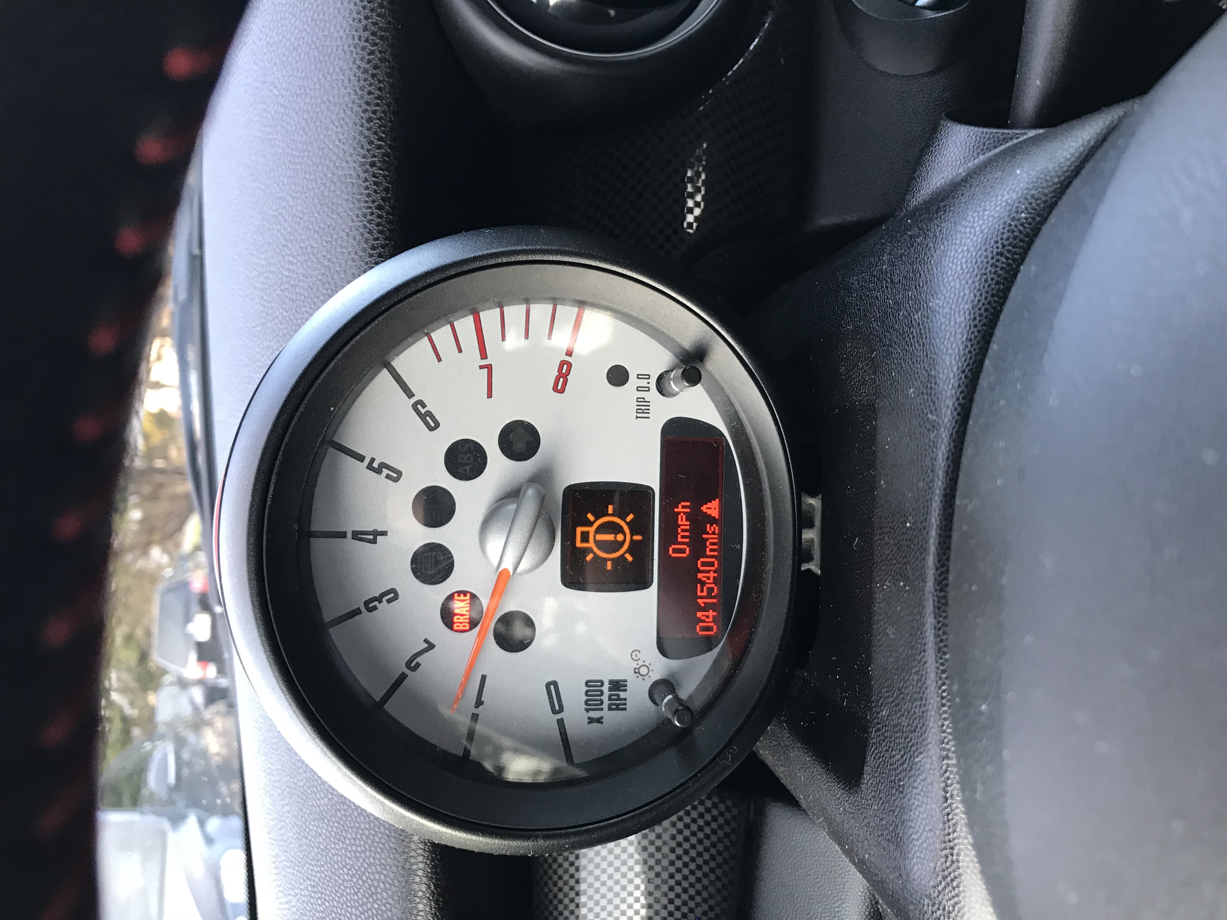

Hi Guys,
I have a 2013 Mini Cooper S. When I started my car in the morning I saw this warning light, within a few minutes is goes away. It doesn't always come on.
Can someone pls tell me.....
thx
jeff

That’s the “bulb out” warning. Need to turn the car on and running, then go through all the lights and check for one that might be out. Did you install LED bulbs on the outside of the car?

I haven't installed LED bulbs. I'll check my lights. It must be intermittent because it doesn't always come on. Thanks for the help
did you find the culprit bulb? I’m having the same issue but visually can’t find the bad bulb

a friend of mine has the license place light burned out...well, actually the circuit was shot from rain and salt. So, check that area.
