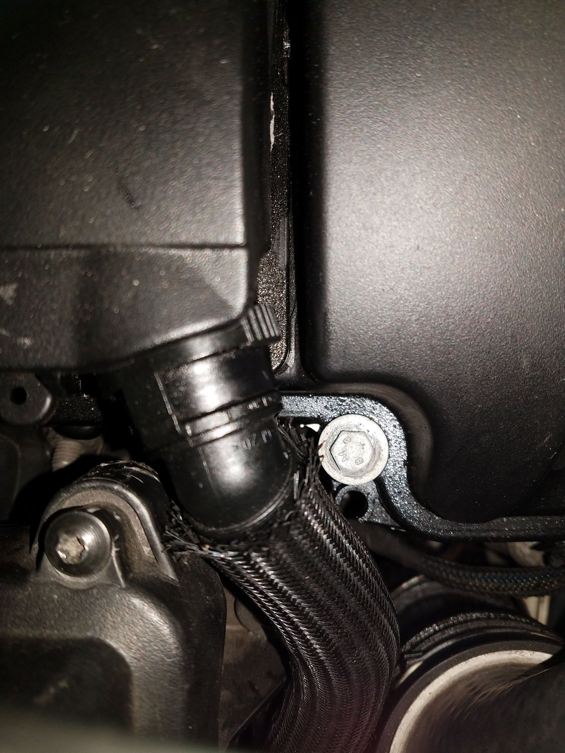

So I want to say I have narrowed the leak to the pcv line fitment area. I am not sure if it is the fitment, the o-ring gasket on the fitment, or the female portion on the valve cover. The only thing I notice is that the fitment can be wiggled easily and three is some oil in the area where the clip is attached to the line. Could someone tell me if theirs moves like mine?
It is not as evident in my photos, but there is between 1/32" play.
Me pulling the line.
Me pushing the line away. Note the small gap at the lower portion of the flange.
Pull
Push

Its has a little bit of play on mine but no leaks, might be the clip or the O ring? Also make sure the bolts around the outside of the valve cover are tight and torque to spec.

Thanks ECS, good advice. I'll check the torque on the bolts tonight. I've cleaned the house connector and am going to watch it over the next couple of days to see if that is the culprit. If it is seeping elsewhere, it may be time for a third valve cover.
