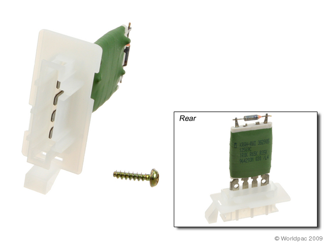

Not for the manual climate control. Thats about it, my guess is the connect as the back is not secure or one more thing the NON auto final stage / blower motor sensor. 64111499121

feels like the BMW E39, FSB
I'm going to try and investigate this weekend. Thanks for the info
Old Jan 5, 2018 | 01:35 PM
Posts: 36,771
Likes: 2,555
Yep like a good old e34 BMW final stage resistor.
