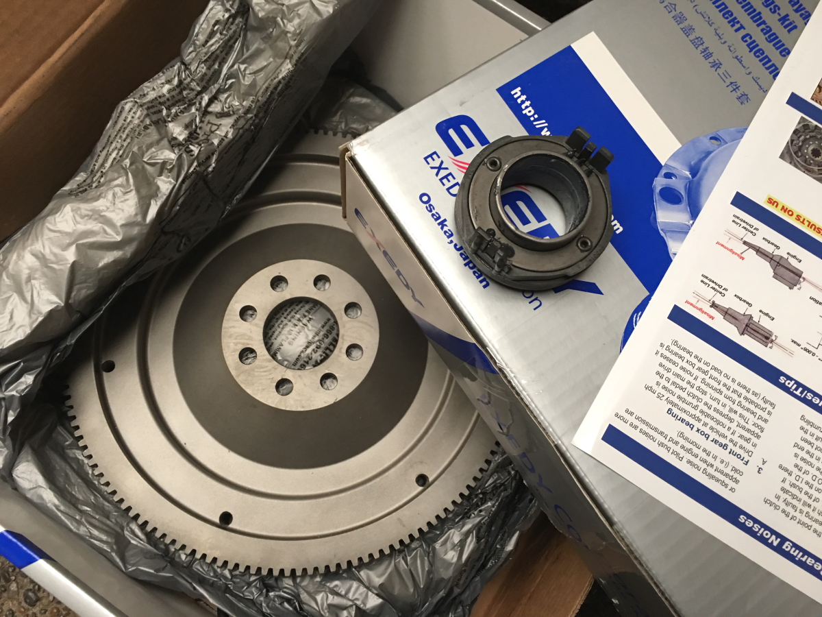

Exedy clutch kit
In addition to the racing clutch kit, Exedy makes an excellent clutch kit similar to Valeo. Its flywheel is slightly lighter than Valeo with a more conventional shape. Price wise is very close to the Valeo.
here is the part number (I paid much less)
My installation.
My reflection of it many months later having used it on track and on street.
