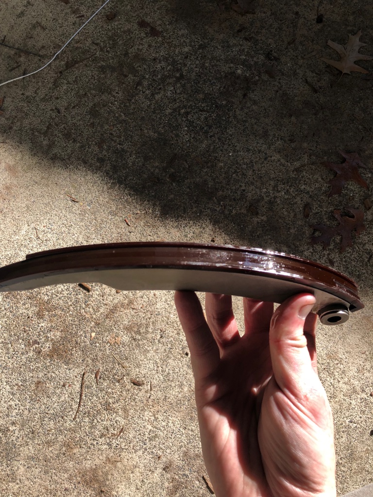

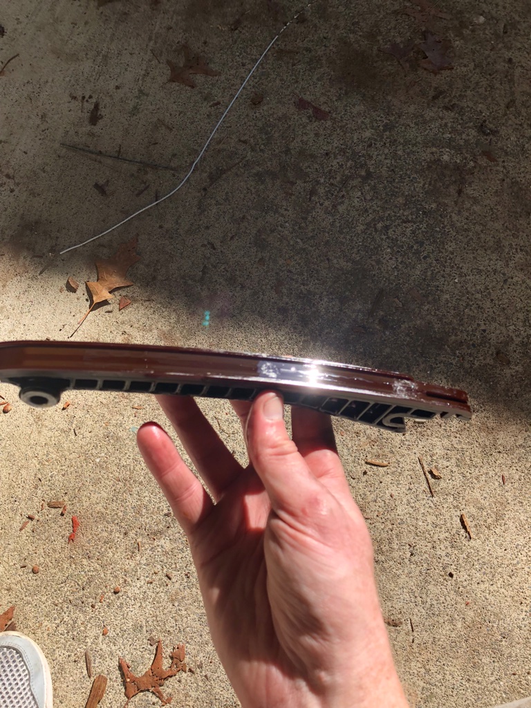

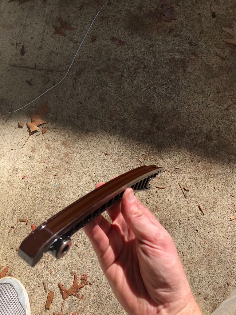

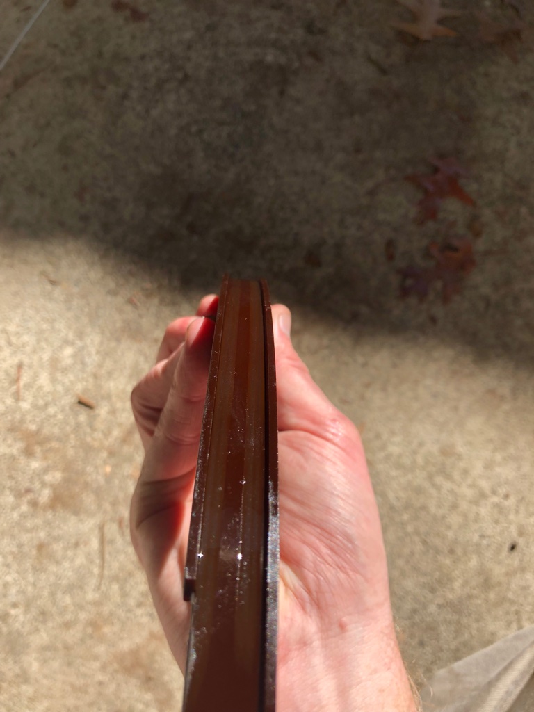

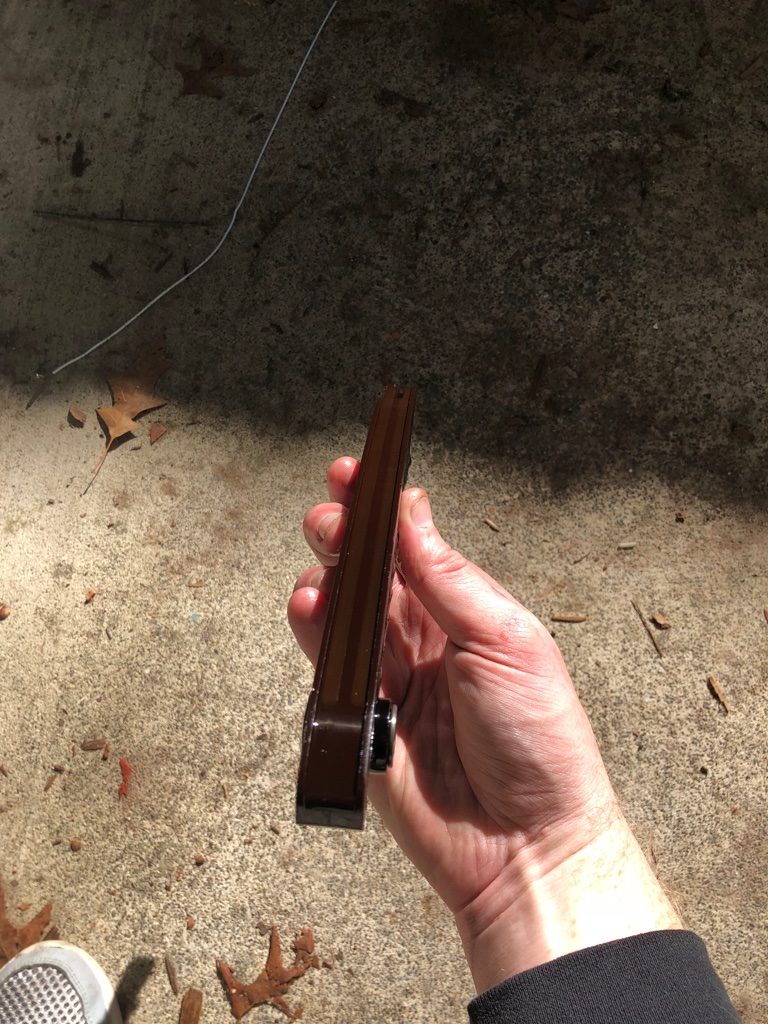

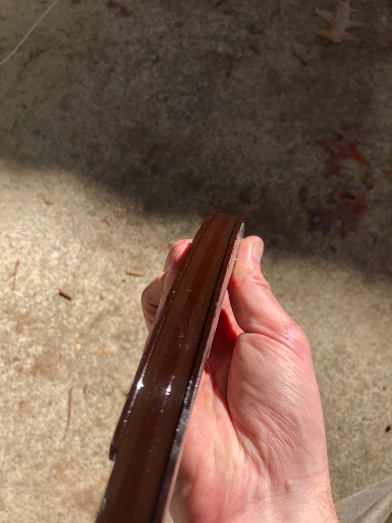

So it was slapping around on the guides because they were worn down a lot. Do you have pics of the old guides?
Here they are, attached. You can't hang a nail on the wear pattern.

Yes, thanks for posting. That has some grove alright.
