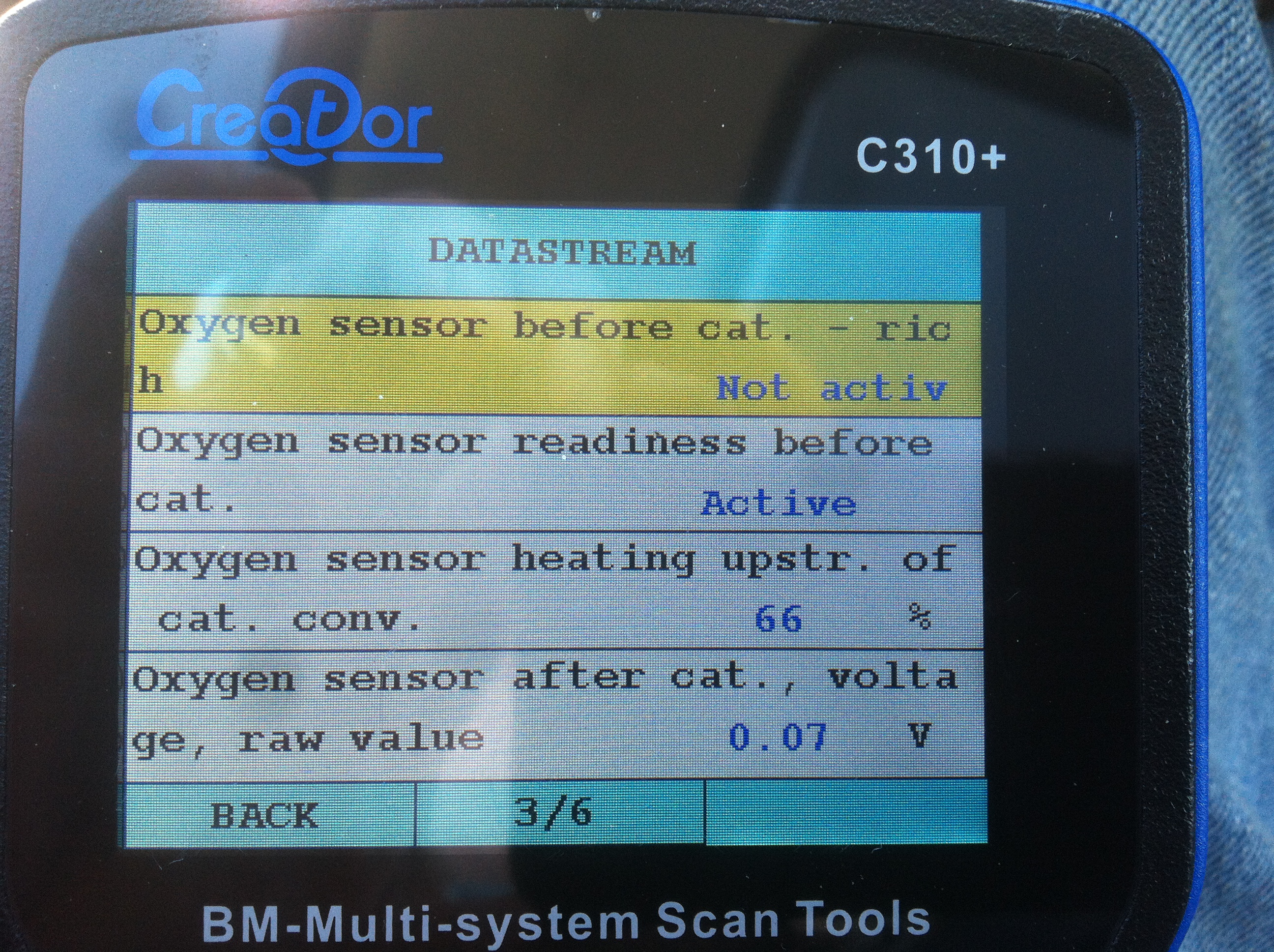

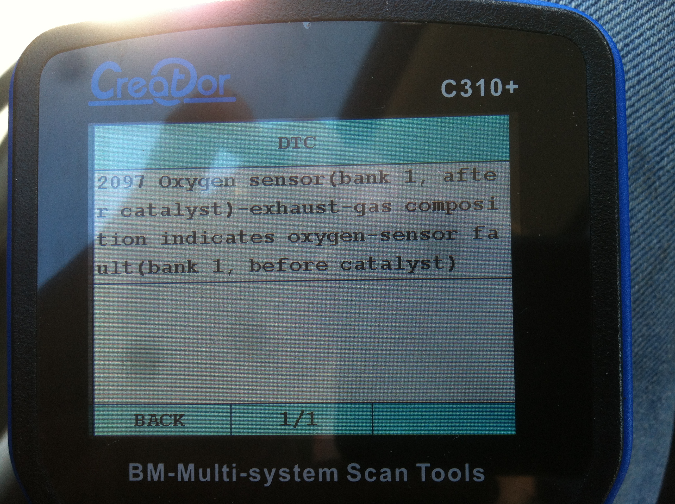

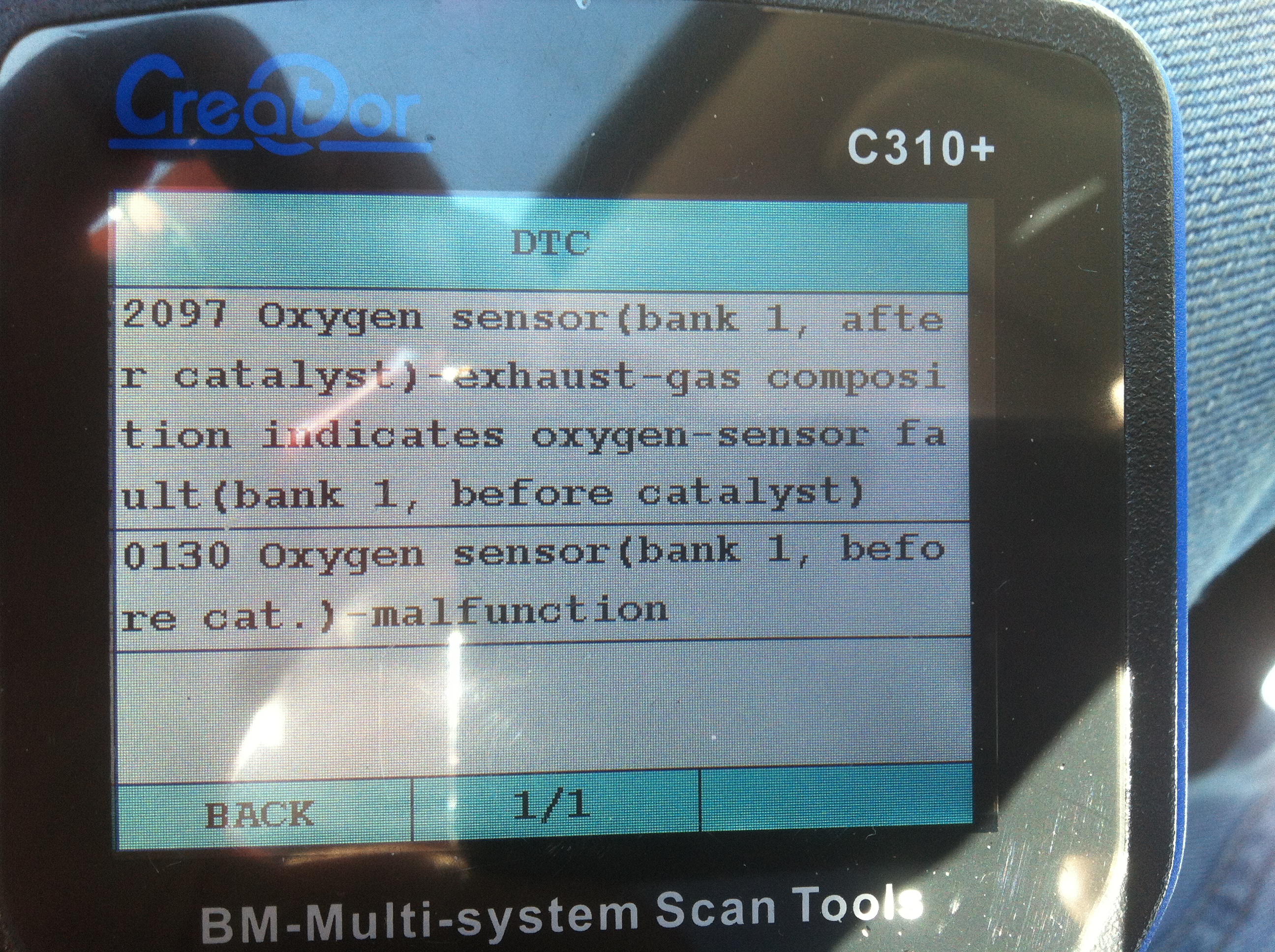

Ok, so I bought a 2002 Mini Cooper for my Daughter, the check engine light is on. I bought a Creator C 310+ scanner to use for the car. The people we bought it from had their mechanic change the # 2 oxygen sensor (after the cat) and said that the code had to be cleared by the Mini Dealer. I've tried clearing the code with this scanner but it keeps coming right back. So after looking at the definition for the code, I decided to replace the #1 oxygen sensor (used a boshe). Now it still throws the same code and sometimes one for the #1 sensor as well. The scanner allows me to monitor the oxygen sensors in real time so I did that. The #1 shows active/nonactive back and fourth. You guys got any ideas for me? I have attached picture of the scanner readouts.

Well I've ordered the NTK sensor. We will try that and see what happens. I have been able to clear the code but once I restart it comes back. My scanner still flashes active/non active in real time. Hope this new sensor will do the trick.

I put the new sensor in and have been running the car for about a week. Car runs fine but the sensor still isn't working right. The active/non active keeps flashing for the sensor ahead of the cat. The sensor after the cat is showing about .10 V over what the one before shows at it's highest level but it is all over the place on average. I've been trying to trace the wires from the sensor but once it goes into the harness by the cylinder head I lose it. I'm trying to see if there is any damage to the wire down the line some where. Anyone have any ideas?
