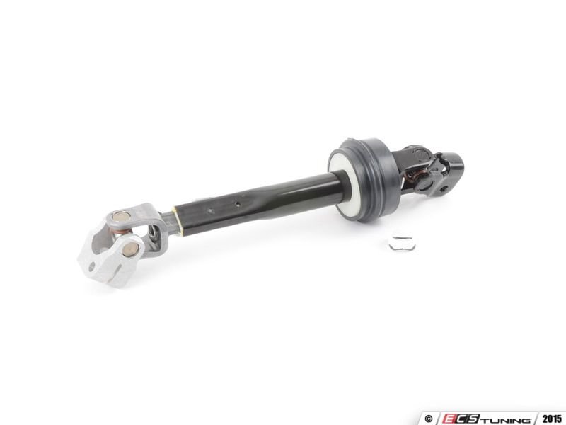

If the steering wheel has play you might need to replace the steering column. My car has the same problem. This is the part I think needs to be replaced. I remember reading it only came in RHD, and you would have to do some modifications to make it fit, but hopefully ECS Tuning can answer that. I'm waiting until its warmer, so I can tackle this myself. For the front right wheel did you check the bearings?

The steering column can be replaced with the subframe in the car, it'll come out the drivers foot well.
Have you personally gotten under the car to inspect the hardware associated with the job that was just done? I would make sure everything is tight, and give the car a shake down.
If the steering wheel has dead slack in it even when stationary you're likely in for a steering spindle. It's only two bolts and a bit of contorting, should only take you about an hour. We've got them in stock if you end up needing one: Steering spindle
https://www.ecstuning.com/b-genuine-...e/32306870777/
Yep, thats the LHD one, MINI had a sort of these for some time and they were using the RHD version ones and swapping them until the supplier could make up the LHD ones. 32306870777
