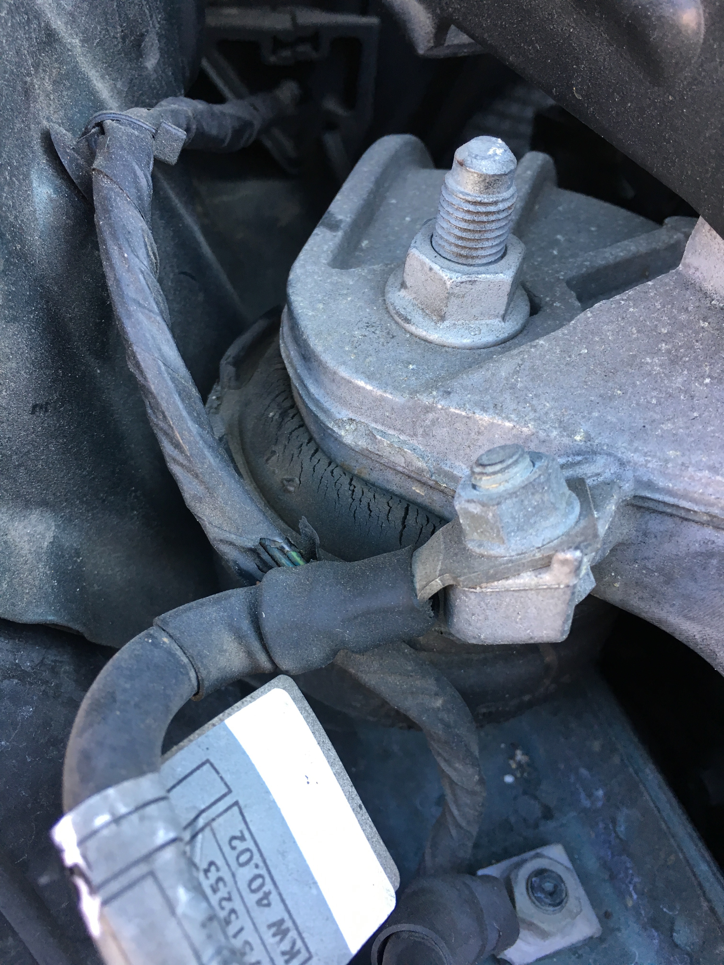

My wife has an 03 R50 Mini Cooper. She adores it. The other day, it started shaking violently when at interstate speeds. After I did some driving myself, it seems to only happen really noticeably when the engine is pulling (passing someone, going up hills etc.)
I know that this motor mount needs replaced (please see attachment). Can anyone verify that this part is correct?

p.s. the pic was taken from the front of the car, facing the engine bay. mount is on passengers side.

That looks like the correct one. The R53 "S" mount is a hydraulic mount that has a metal casing. If you go to ECS tuning and enter your vehicle information, it will show you all the correct mounts available for you car.
Im getting ready to replace all the mounts on my 02 R50 and you'll need 4 mounts. There are two on the passenger side(one mounted to inner strut tower and one mounted to the frame rail), one on the bottom/rear of the engine and one on top of the transmission.

Yes taking off the engine mounts on the R50 and R53 is the same procedure.
Looking at your picture that mount is for dead. It's actually about 1/2 inch or more shorter than it should be. As they get old they actually get short. But now you will also need to replace the mount on the strut tower that has the bar that connects down to that mount. If you look at the X shape rubber in the mount on the strut tower you will find that the rubber is also broken and why it needs replaced. We stock them and have ready to ship asap.

Just a little update. All parts came in and I made the swaps. The car feels totally different now. Super smooth at idle, smoother shifts, etc. It's great! I did all but the transmission mount. The car still starts to shimmy, but now it's around 30mph and not nearly as pronounced. I can safely, smoothly travel 70-80mph now. I went ahead an ordered the transmission mount and will be putting that on soon.
A couple of notes. I had to take off a bracket in order to get the new passenger motor mount in. (see screenshot) The other one was in two pieces and shrunk by about 1.5". I jacked up the engine a bit...didn't help
New mount is in in this picture
I think it was a bit of a goner.
Cracked all the way through.
