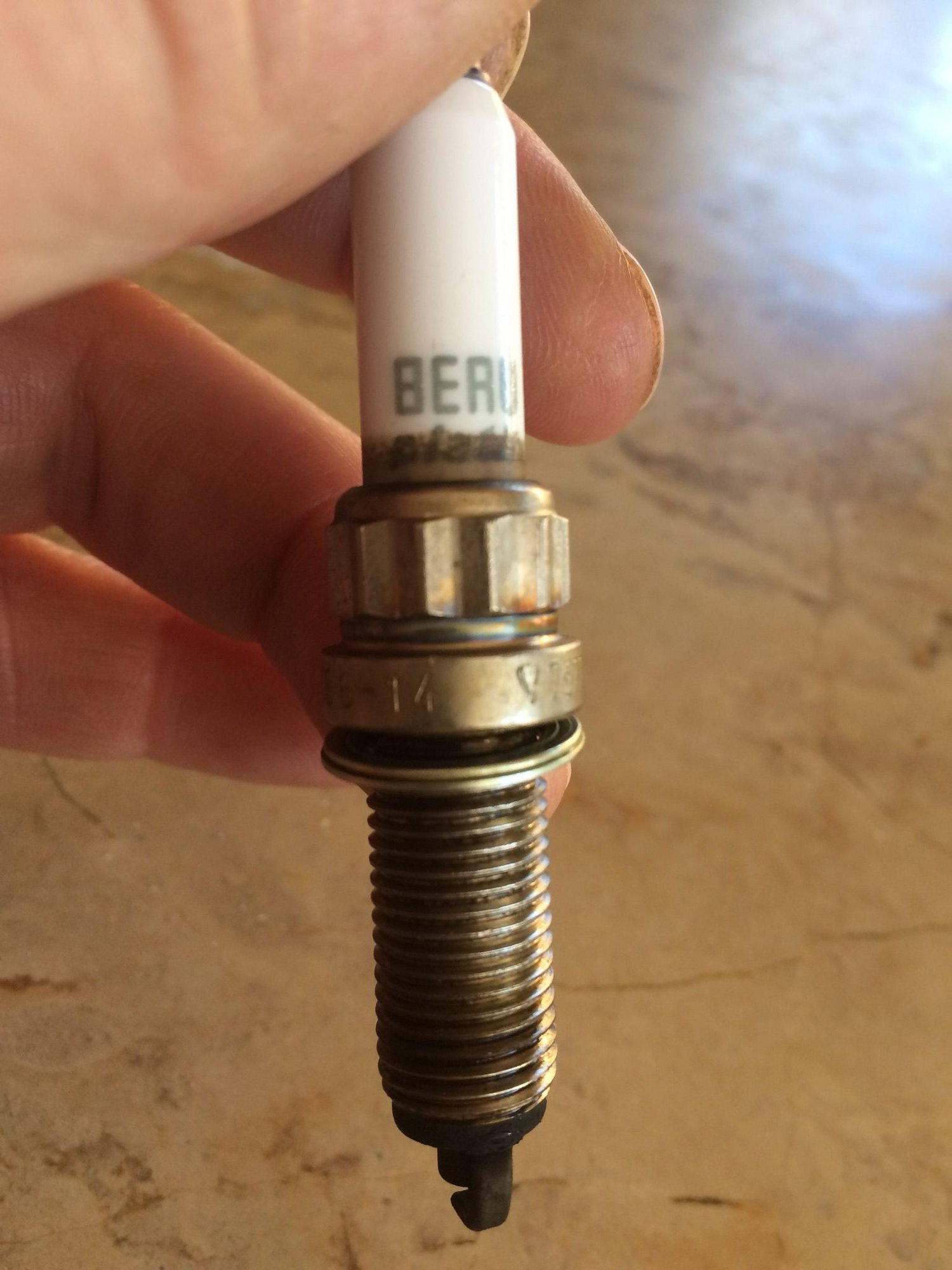

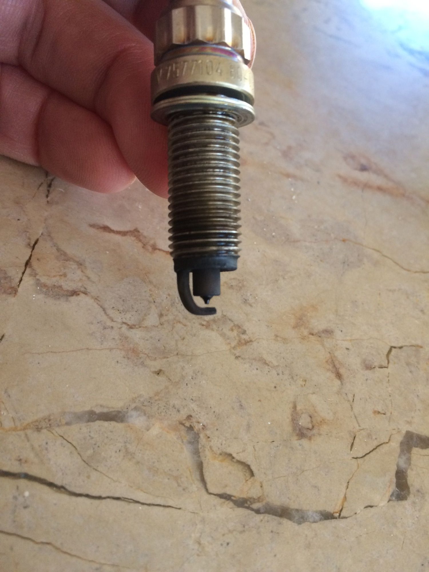

Never got far (yet). Pulled plugs to do a compression check.....cyclinder 4 plug is weird - insulator and core move independently of the threaded portion (both rotationally and vertically), so the gap can change constantly! It actually looks like there's blowby on the insulator above the nut portion of the threads (I'll try to attach a photo, but not particularly tech savvy, hence the oversize). That'd easily explain the misfire on cylinder 4! BERU 12ZR-6SP03 plugs replaced in May for what it's worth. No more time available today - maybe tomorrow.
What looks like blowby on the insulator
Gap at narrowest,
Gap at widest,

perhaps that solves the mystery!

Wow, that's definitely a plug failure. We're all hoping that was the issue, and it sure seems likely

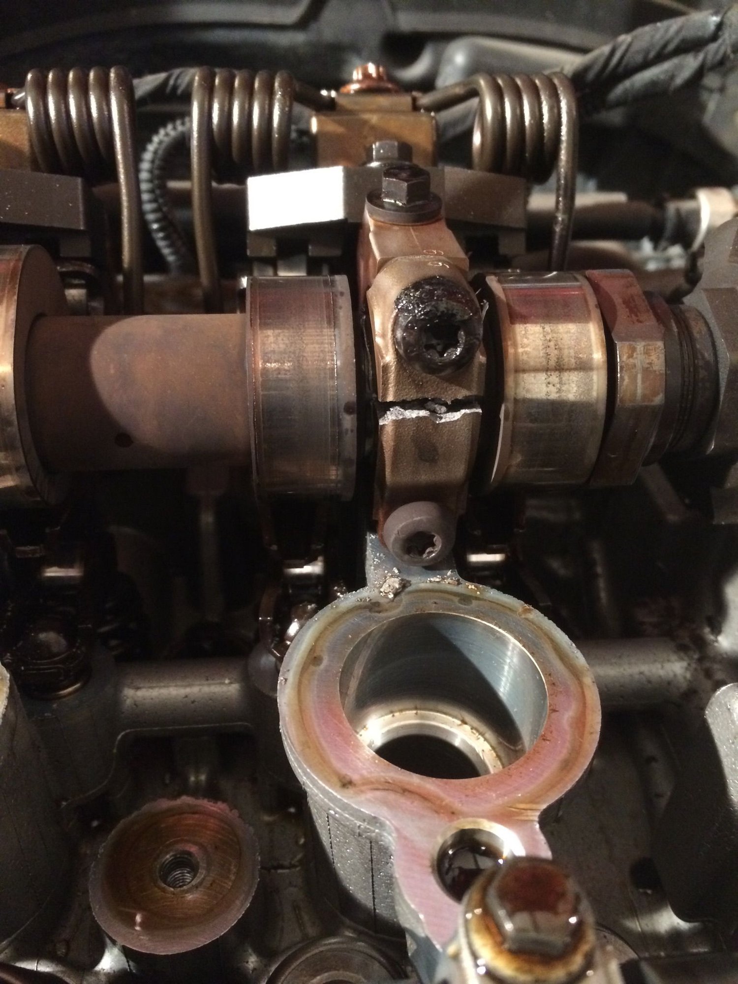

Had 10 minutes today to at least pull the valve cover. Found this on intake side for cylinder 3 and 4:
Cylinder 4
Cylinder 3
Go figure that it quit running!
Cam 'looks' tweaked sideways (current orientation) just before the cylinder 3 carrier, this is NOT gonna be a quick head repair!
I will pull the head at next opportunity, but I expect more frightening images to be found on pistons 3 & 4 - which in turn would cause me worry about connecting rods and crankshaft damage. Anyone in the NW have a known good used complete N12 sitting around?

I discovered the hard way that the cam caps (on an '07 MCS) are part of the head and not replaceable by themselves. Seems the cam journals are line-bored as an assembly for the cams. Maybe the N12 head is produced differently? Regardless, check out the bottom end before making any big decisions.
Talk with your local Mini parts guy about replacement engines, their engine prices aren't that bad, and usually preferable to a used engine. A knowledgeable indy shop can do the exchange for a much better price tho, unless you DIY.

Ski season is wrapping up, so I had a few days in the last week to perform open heart surgery and drop a used motor in. I never did pull the original motor apart beyond removing the cylinder cover to find the cam bearing caps cracked.
Regardless...used motor with good compression numbers, 92k kms, replaced: timing chain and ancillaries, crank seal, new rear main seal, valve cover gasket, pulled the oil pan to check for chunks (all good) so resealed it and added a magnetic drain plug. Tranny side got a new clutch and associated innards, new axle seals and a thorough scrub. The entire process isn't bad, I compounded the challenge by leaving the AC system charged and in place - THAT's another level of awkward I hope to never repeat....it means disconnecting a bunch of the bumper attachments on the driver's side in order to snake the plumbing in and out AND the AC compressor bolts are a serious PITA. Oh...the assortment of proprietary tools needed are another PITA. It's done, not sure it made financial sense, but it was too good a car to send to the scrap heap/part out.
