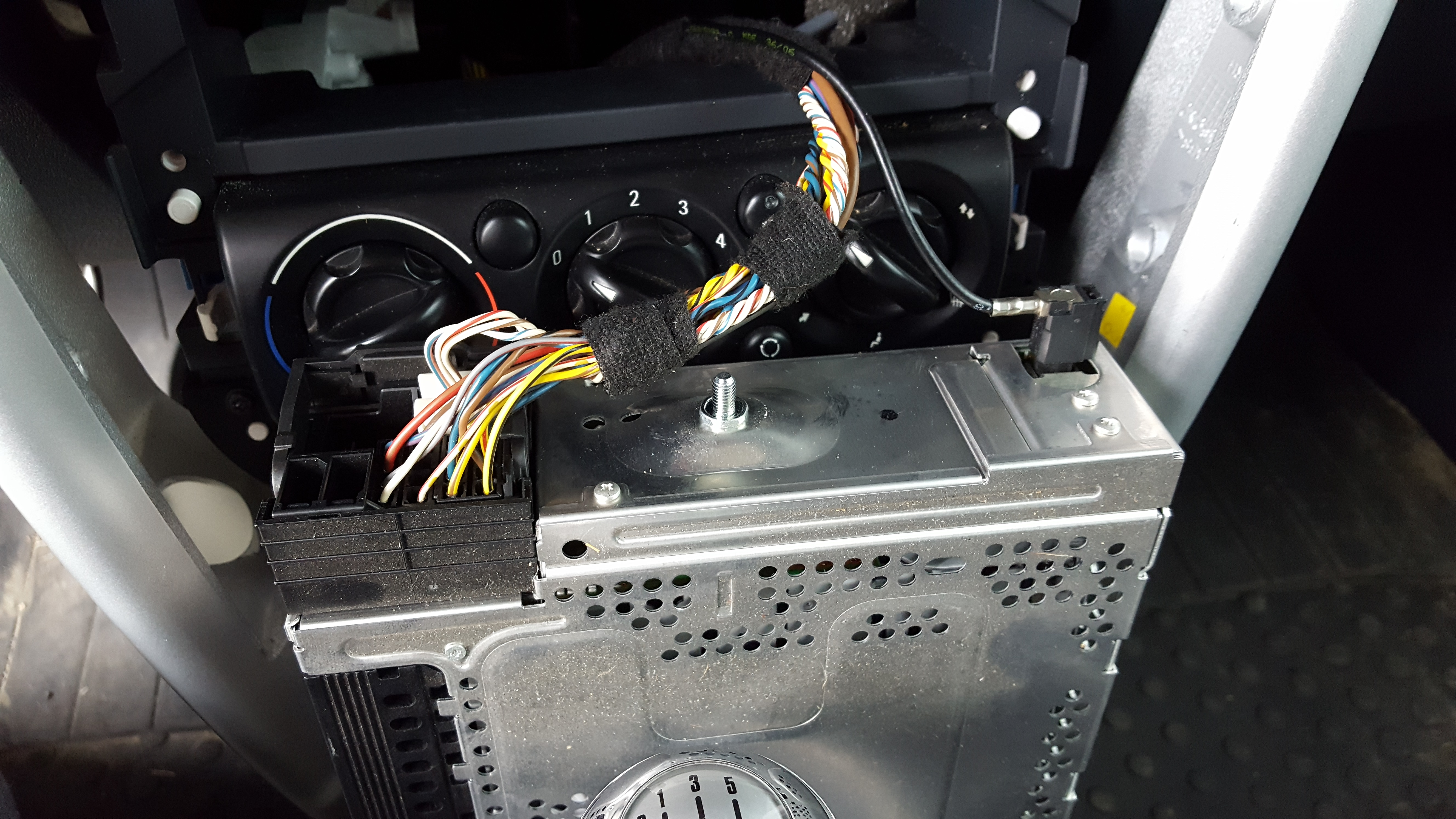

Broke open the dash today.
I unplugged and replugged the 'antenna' - far right of the image. With it out, nothing but static. With it in, little bit of static (which has been common). The particular station I was trying to pull in is 20 miles away.
As has been typical, sometimes the one station is clear and other times not. Sometimes I can pull in other stations that are further away clearer - but everything is intermittent and nothing is consistent.
From here, the cables all go into the loop and up under the dash. BTW, I know the wiring nut is not on, it was off for the image.
Where should I check next?
