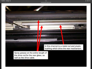

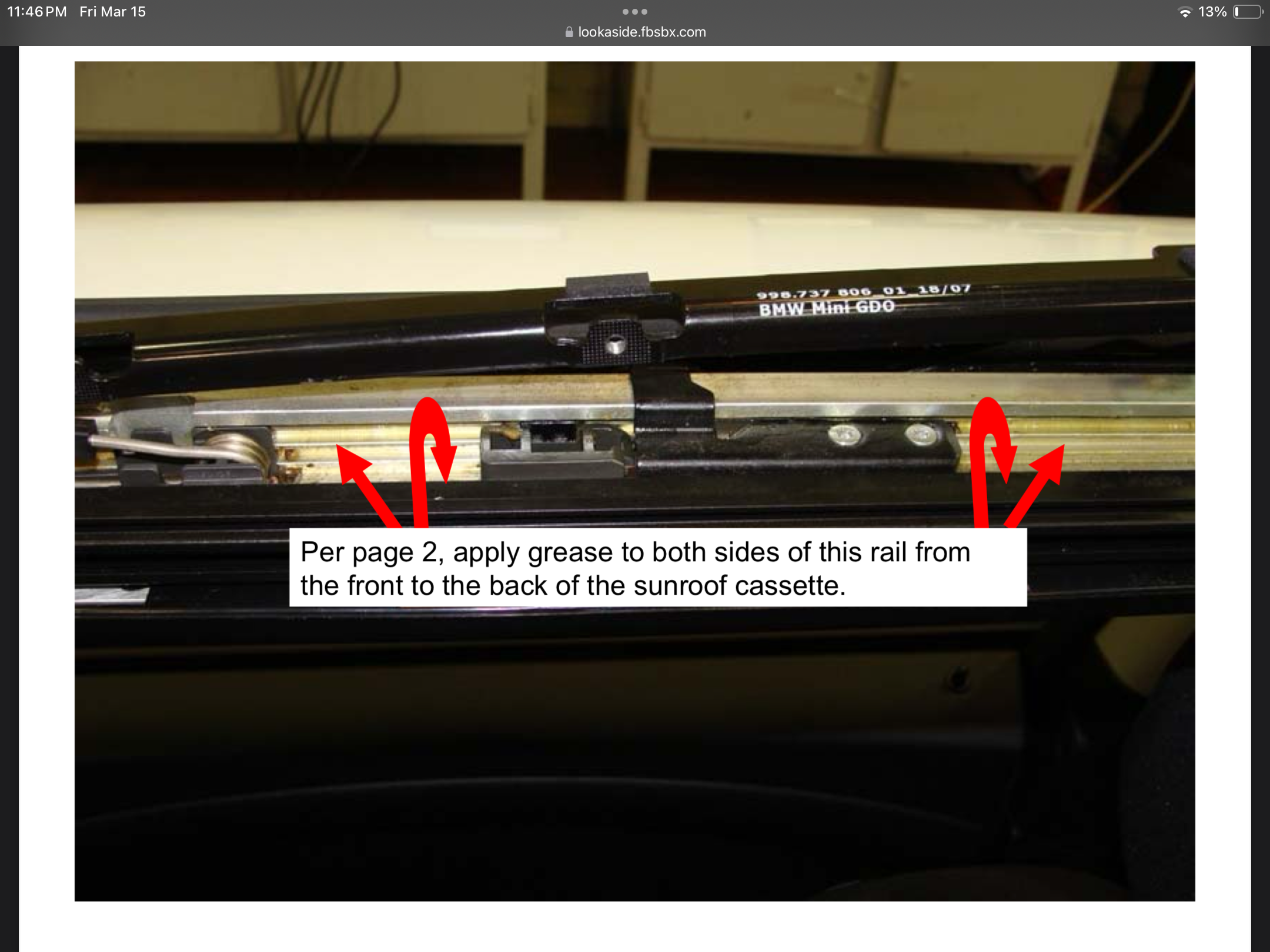

Hi and how you apply it ? where ? only in the rails ?, thank you so much!!!

This is for R56 but should be similar. If the link doesn’t work for you, post and I’ll post pics. https://lookaside.fbsbx.com/file/Sun...cZNML5FrpWbpyQ

Here you go.
Attached Thumbnails Sunroof lubrication-img_0226.png   Sunroof lubrication-img_0227.png   Sunroof lubrication-img_0228.png   Sunroof lubrication-img_0229.png   Sunroof lubrication-img_0230.png
