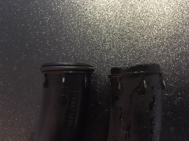

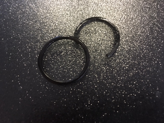

I finally got everything apart and the water tube removed. A lot of the plastic from the collar towards the water pump is missing - basically the groove that retains the o-ring. So that is my leak. It is also why it never felt like it actually seated when I tried to push it back into place, the o-ring was seated, just not attached to the water tube.
My concern at this point is where did all those pieces of plastic go? The o-ring was still seated so I used a pick to remove it and a shop vac over the water pump opening to try and remove any debris, but nothing...

Finally finished up the job. it was the water tube leaking. Supposedly it was replaced when the water pump was done in April, but I seriously doubt that.
I've attached a couple of pictures. The o-ring and plastic remains are what I fished out of the water pump housing and you can see the end of the tube is destroyed. No wonder it was leaking.

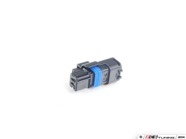

For anyone who may read this post, I found the problem (I think, who knows with this beast
The connector that goes on the temperature sensor is brittle and broken internally. I pulled it off and noticed it was loose and a simple tug pulled it apart. It was not actually connected tightly even though the housing was in place.
So, does anyone know where to pick up these connectors?
Here is a picture of the connector (PelicanParts picture - and if you have the connecter I'll take one) I know they say it sometimes comes loose, but the blue rubber piece is missing and hard black pieces came out when I pulled it off the sensor.
)The connector that goes on the temperature sensor is brittle and broken internally. I pulled it off and noticed it was loose and a simple tug pulled it apart. It was not actually connected tightly even though the housing was in place.

Edit:
I think this is the connector. I ordered one, so in a week we'll see...
https://www.ecstuning.com/Mini-2007-...2B16A/ES31710/
