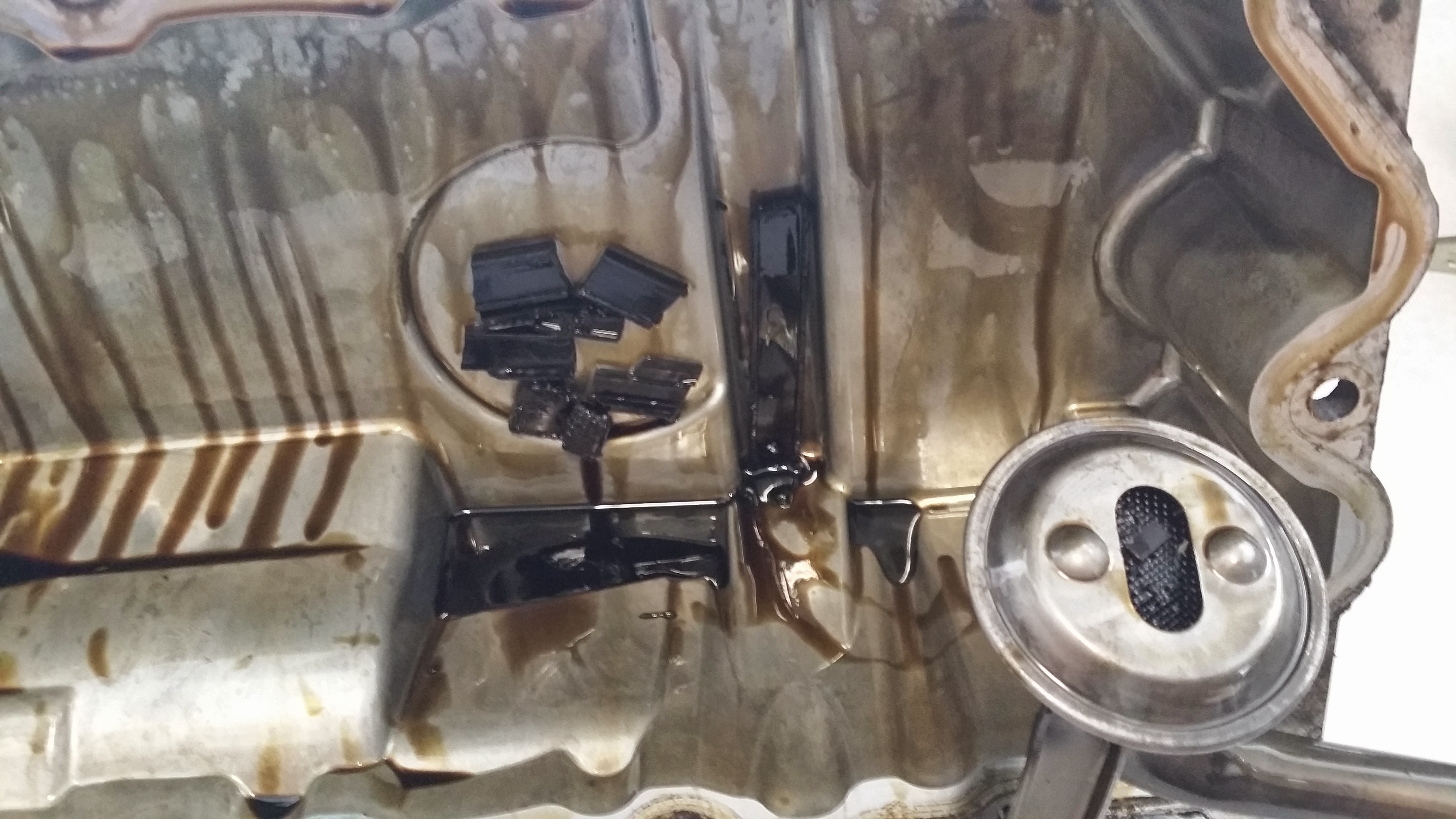

You are looking at a broken timing chain guide. That probably occurred due to the timing chain tensioner failing. What your are not seeing is that there are probably many more little pieces of plastic shrapnel that are in your oil pan and are now sucked up into your oil pickup screen starving your engine of oil.
Like this:
https://goo.gl/photos/ZM8n6oB1ySf5ieRe6
Attached Thumbnails Anybody have an idea of what this is?-img_20150521_133003-nopm-1-.jpg
