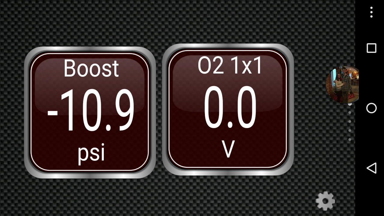

I made a phone call to Detroit Tuned to ask them if there have ever been any issues with their bypass valves, and he said no. He also suggested that it could be the quality of the rebuild done on the supercharger that was installed. I doubt that this is the issue but I may be wrong. He also suggested that I could zip tie the bypass valve closed and see what happen, so I did. Using a OBD II Bluetooth adapter with my phone, I was able to see "Boost pressure." Now what i'm confused about is that, even with the bypass valve ziptied closed, i was still getting a negative pressure until I stepped generously on the pedal in which case it would go positive. Why would it go negative with the bypass valve ziptied shut?
So after doing this, the car still lacked power.
Upon some research it appears that these fuel pumps can go bad if the gas tank is ran dry (i've never ran it dry, but i'm not ruling out the pump). So I decided to check my Bank 1 O2 sensor voltage while I drove, figuring that if it ran rich, i would see it. When driving average the voltage stayed between 0.6-0.8 . When I would step on the Gas, the o2 sensor voltage would drop to 0.0 and would not change until I let off the gas a lot.
(I have attached a couple of photos. The first photo, is with the bypass valve ziptied shut and coasting at about 30mph. The second photo is with the bypass valve ziptied, in second gear and about 75% throttle.)
The most boost I can get, is about 12 psi in first gear. Does that sound right?
So what do you guys think, is it a fuel issue, or a boost issue?

I was surprised by this initially too, but you will stay under vacuum at the intake under most driving conditions until you really step on it. You are getting boost, but not enough to move from vacuum to positive pressure. If you hook up something like a scan gauge II, you can see the MAP readout as you drive. It reads absolute pressure in psi, so 14.8 psi is atmospheric pressure at sea level.
I've had sluggishness like this when my map sensor got oil fouled. Try cleaning yours....

Should I still see a vacuum even when the bypass valve ziptied shut? Thanks for the MAP idea, i'll try that tomorrow!!

My power is back!!!
Great News Everyone!!!
I cleaned my MAP sensor and decided to take one more look along the intake for anything abnormal and caught a vacuum hose disconnected on the supercharger outlet horn. When i popped it back on it went on fairly easy so i expect it to pop off soon. I'll be ordering a replacement. The car seems to have its power back!!! My O2 sensor voltage no longer drops to 0.0 when i step on the gas. So thats awesome! I posted a picture below of the pesky vacuum line that popped off.
Thanks David.R53 for the MAP sensor suggestion and thanks for everyone's

Yes, you're still throttling the engine at low loads, so you'll see almost normal vacuum levels at very low loads (eg. Idle). The bypass is there to reduce supercharger work when boost isn't needed. This improves fuel economy.
