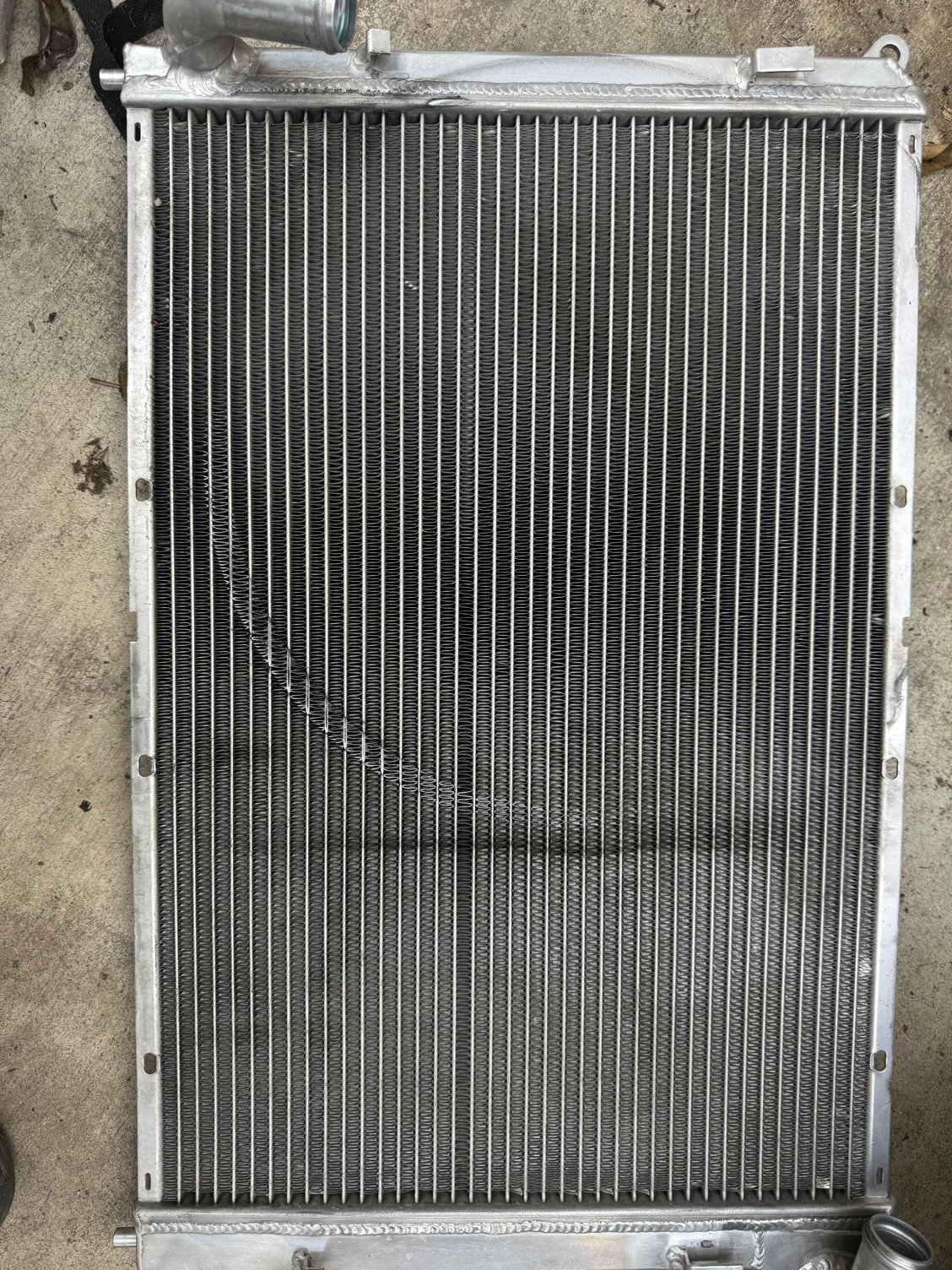

Old *** thread but… being I’m in my second replacement for the same issue again… I think I e found the issue. Seems like the oem fan rubs against the radiator with time and punctures it. I’ve replaced my fan the first time maybe thinking the old rad fan was wobbling or whatnot. Bought new one in fcp just to weed out the issue again… and now less than 15k miles after or so … same crap again. Granted they’ve been great at replacing it… it’s kind of a dumb thing to be dealing with every other year or so… with it not being something on our part. Seems like it’s a clearance issue with oem fan smh
This is the new one…
This one as you can see is dated 2019 almost 2020 by the time I installed new one.
