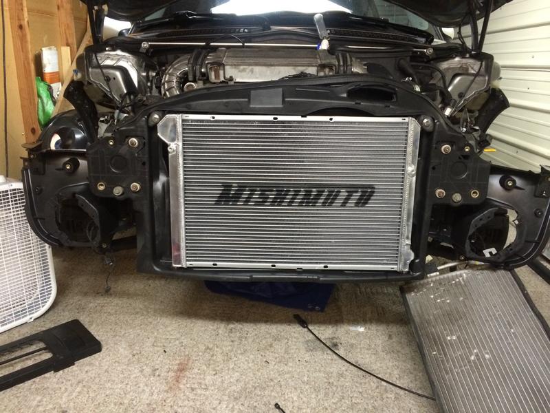

Mishimoto Installed!!
Went with the Mishimoto brand radiator it seems to be the best one to if nothing else for the warranty alone.
