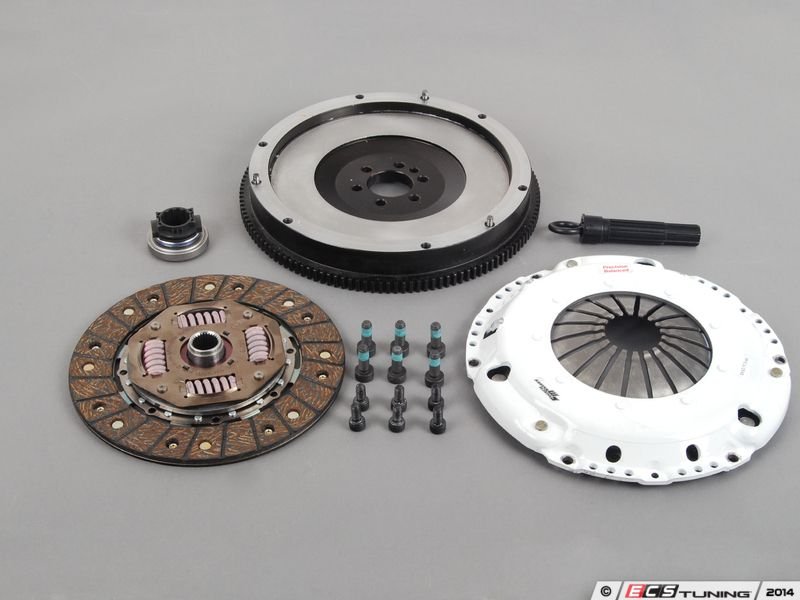

What model do you have Cooper S. If you diy it you can do it for less ? Go with a Clutch Master Dual mass to single mass~ 1100 for it, dual mass stock is expensive. or quote a indy shop to do it, of course it would be more. Dual mass flywheel stock and clutch kit stock would be around the same cost.

I wouldn't drive it much if you know the clutch is bad. As an option, we have some kit options HERE and some info on if you wanted to do the flywheel conversion. If you have the tools and are DIY savvy we have a article that can help you do the job, which will save you a lot. Otherwise, you could take it to an indy shop and have them do the install, which would cost you way less than $2500. If you have any questions let me know and good luck.
