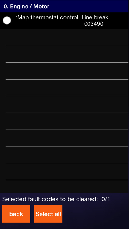

Any idea what is this fault code? Which is the damage part?

You need to get a reader that can read MINI fault codes. What symptoms are you having? Just a CEL triggered?

Thats a stored code fault by the looks , could be a wire break or mis-connection at the thermostat sensor. I would get a better scanner to read more into it.
Have you inspected all the electrical connections at the thermostat housing

I will send to workshop to ask them check on the electrical parts. Thanks for the adverse.
