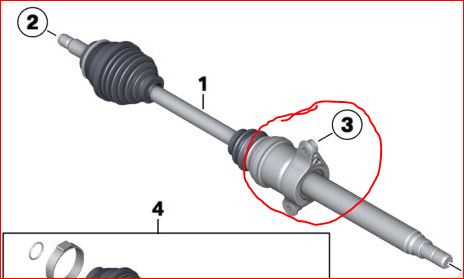

There is a support bearing on the middle of the right cv axle.
Can that bearing be replaced short of buying a new CVD? Every now and then (not often) I get a moderate vibration on the front right that can't be found on multiple inspections. Alignment is always spot on and tires wear very evenly.

What about the middle carrier bearing...?
Old Feb 8, 2016 | 06:56 AM
Cockpitcreator's Avatar
Cockpitcreator
Joined: Feb 2016
Posts: 11
OK...its the center axle bearing....ideas? I looked on youtube and came across the video of how to replace the front axle and this would include the axle bearing.
