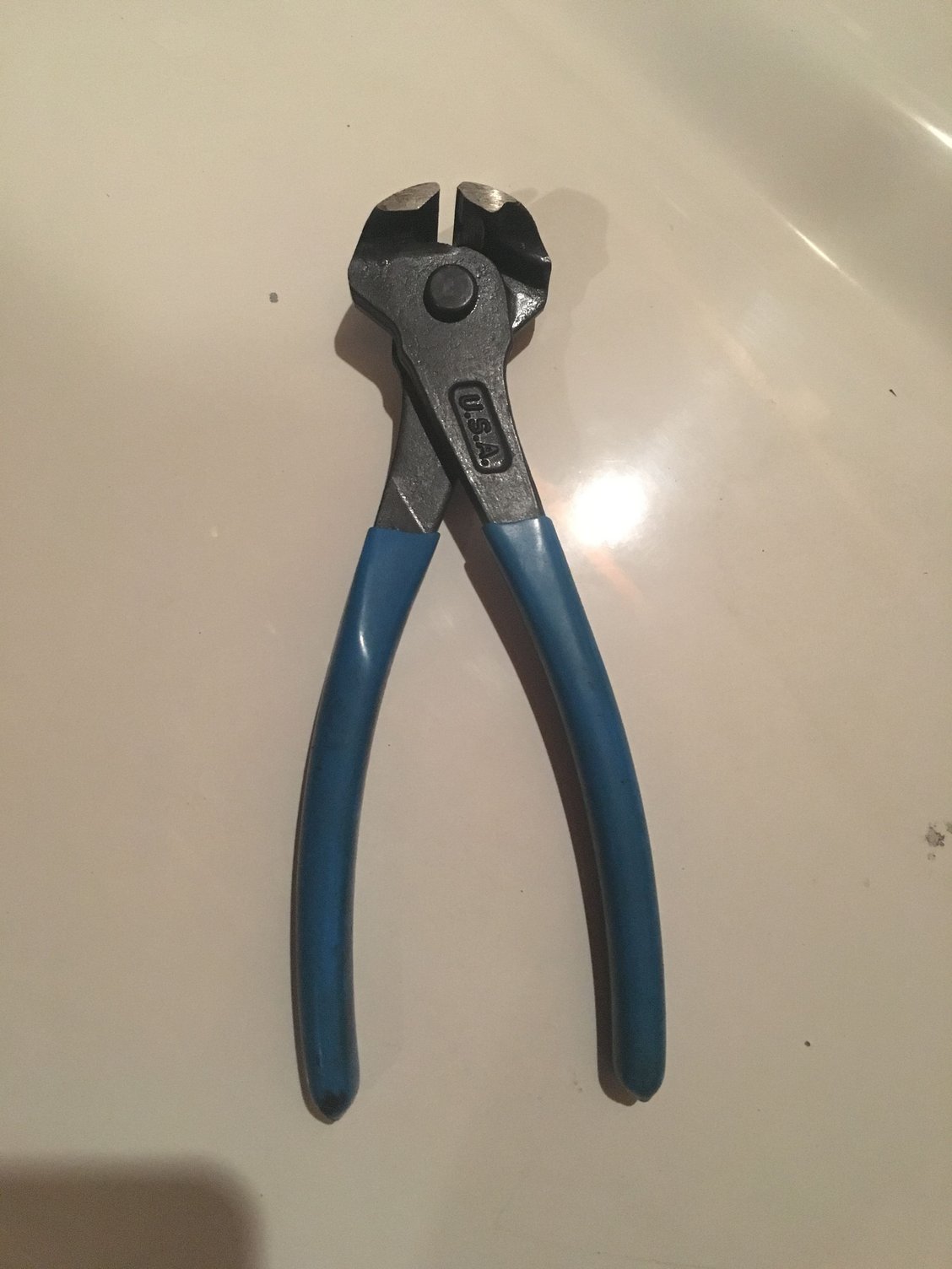

+1 on clicking/noise/abnormal play being the death of a cv joint. Fwiw I replaced both inner boots on my car recently and it wasn't too bad a job at all. I'd never done it before but I found a good diy on this site.
Basically I removed the big axle nut, wheel, brake disc, caliper, brake dust shield, and wheel bearing/hub. Cut the old cv clamps, and pull the joint apart. Clean all the old grease off, apply new grease, put on the new boot, and then fight with the clamps.
You will need snap ring pliers, and the special cv boot pliers help. I made my own by taking some end cutters and filing the edge off of them. (Couldn't find any of the right ones and I needed to get the job done)
I've also seen people use standard screw type hose clamps and I think that would work and save you a lot of grief.

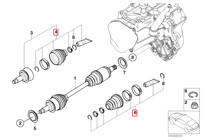

Thanks for the feedback. I'm confused (happens a lot) as to which is the inner vs outer boots. Anyone got a diagram?

Have you got a photo of your homemade CV boot pliers?
The outer boot is #4, which when you look at the full axle #1, it's located on the left of it and is the one closest to the wheel. The inner boot is #6, when looking at the axle #1 it's located on the right and is the one furthest from the wheel. Hope this helps.

Here's a couple of pictures. I think you can get a pair at Home Depot for $10 and then just file the edge dull. I think they're 7 inch pliers which was good for being big enough to give me enough leverage and small enough to fit into the space they need to.
