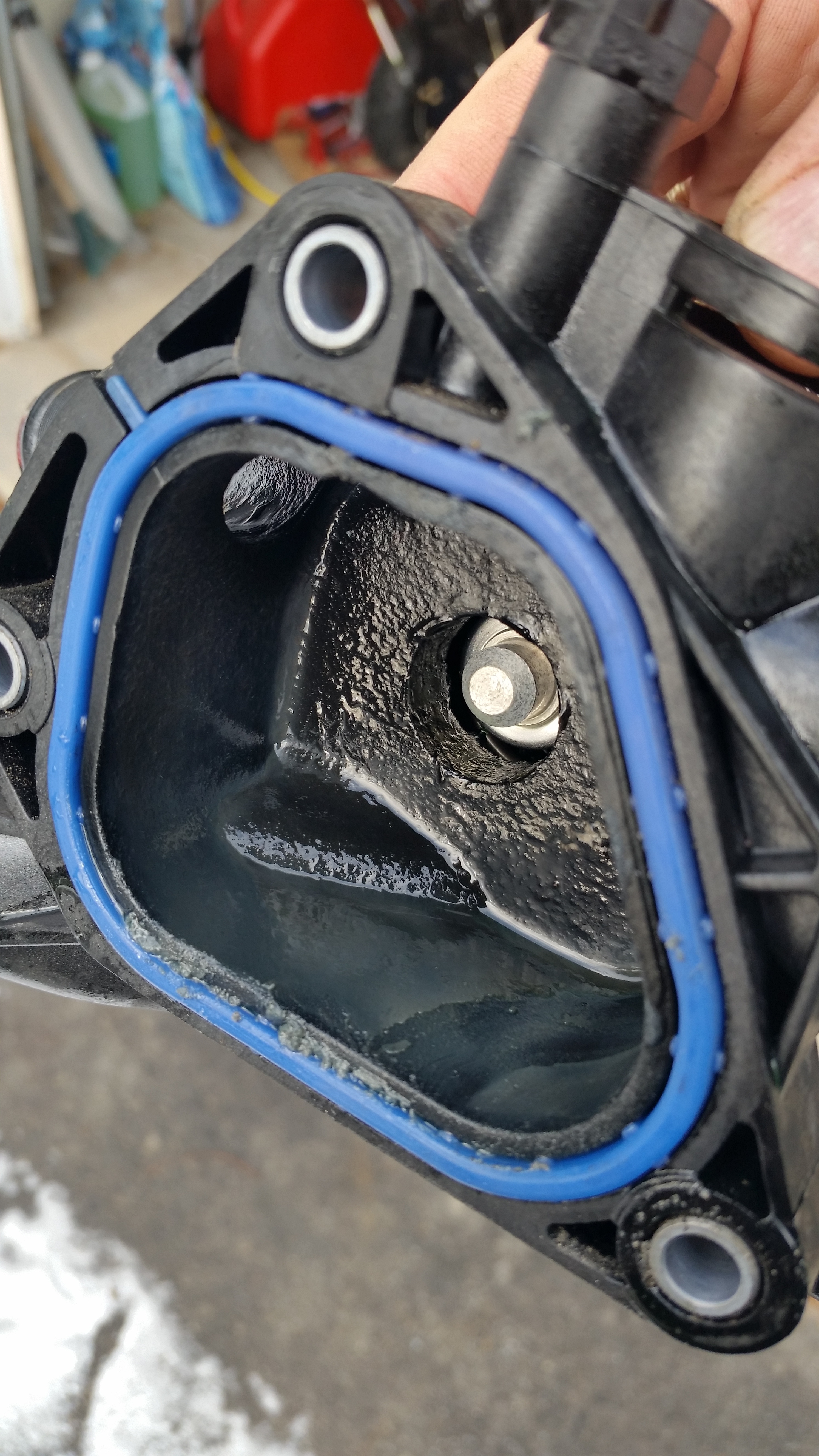

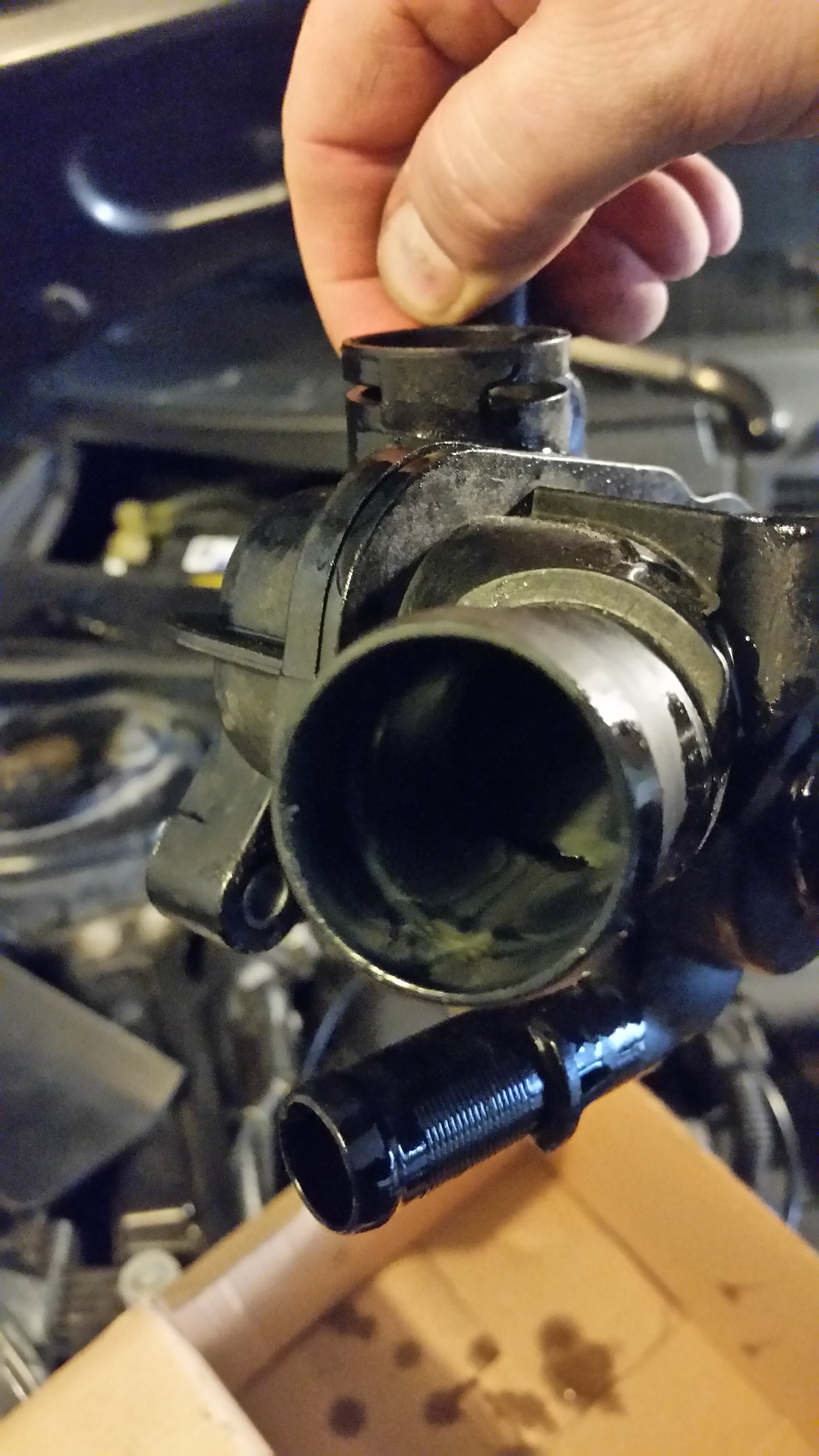

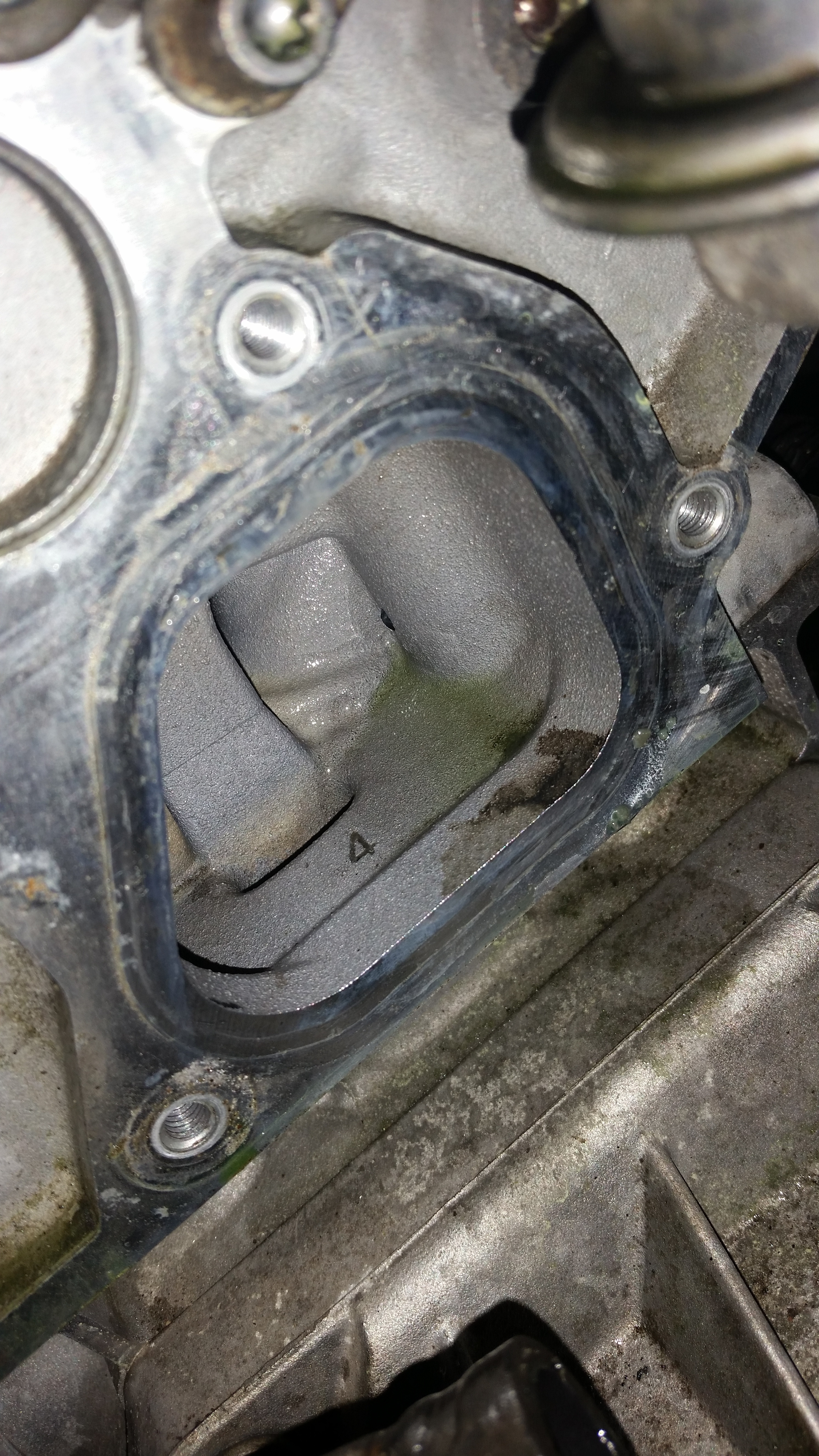

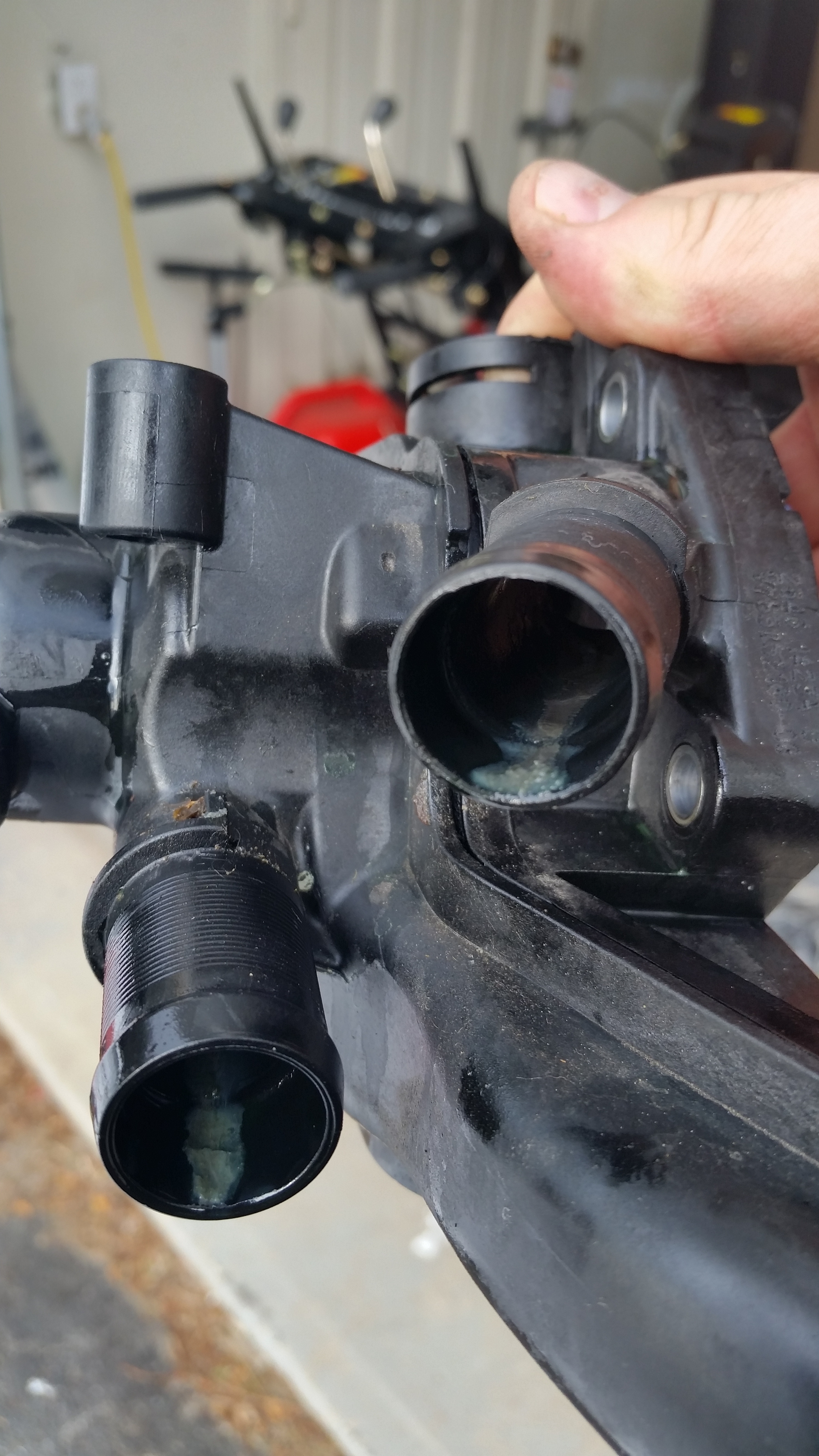

Ok so I started on the thermostat replacement, got the old one out, but am concerned about the residue I found in it, is this normal, thoughts?
This milky residue does not show up anywhere else, dip stick, oil cap, expansion tank, etc.
Thanks!

Could have been form an oil cooler / oil housing gasket leak and fix and the residue from the oil leaking into the coolant ( was no flushed all the way ) or you have a leak in that section ?
Has its been changed.
https://www.northamericanmotoring.co...placement.html
Responded to all your PM's I am glad to help.

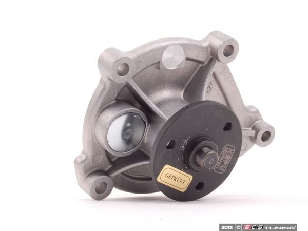

Finished thermostat.. still overheating..so I moved on to the water pump.. got it unbolted. .how do you get it out of there? I don't have enough space in any direction.
Any tips?
Thx

Go to our site. Under MINI > Tech Info (tab at top) > R56 Articles > Cooling System - 5th article down under that is the water pump one. It will help you a lot as you will have to slightly lower the engine to access the water pump, which is attached by five 10mm water pump fasteners (red arrows below) This info and image is all from that article. Let me know if you have any questions.

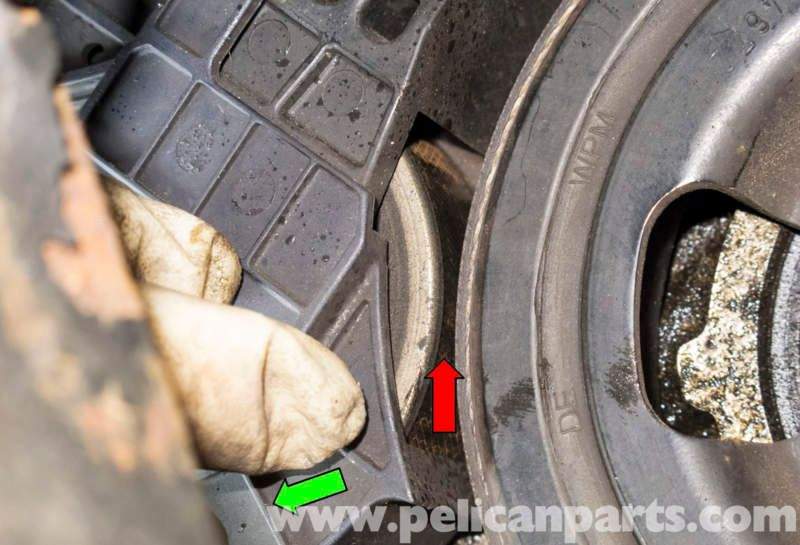

Also what is the best way to test the friction wheel assembly?

The friction wheel (HERE) can fail a few different ways. The pulley or the pulley bearing can become noisy, causing a high pitched squeal or scraping sound when the engine is running. The friction wheel internal tension spring can also fail, causing reduced pressure on the water pump pulley. This can cause slipping and engine overheating.
To check for a weak internal tension spring, pull the friction wheel away from the crankshaft pulley (green arrow). If you can move it and create even the smallest gap (red arrow) it is faulty. This and more info can be found in our DIY for its replacement.
