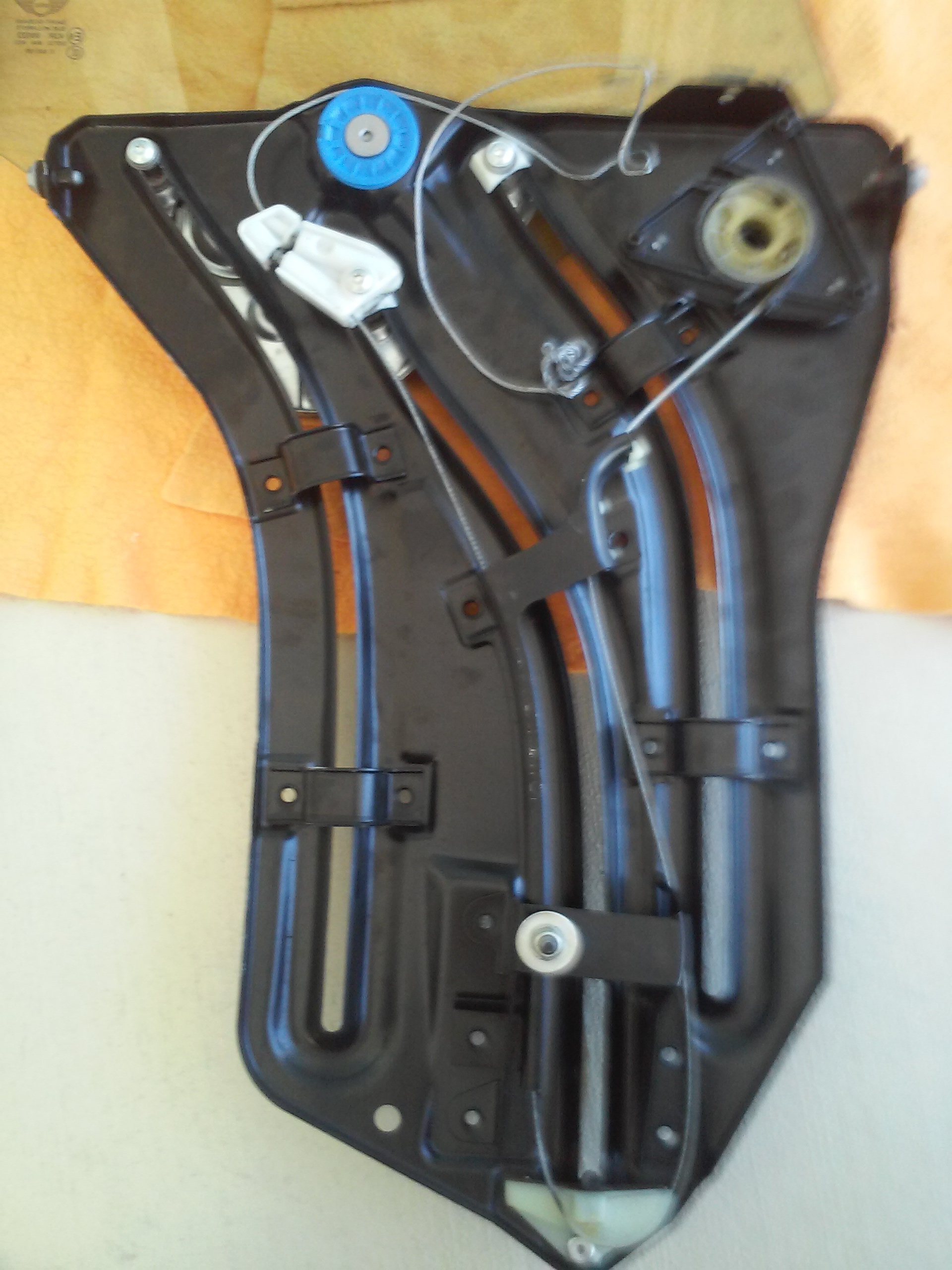

Finally got round to opening up the panels to get to the right rear window regulator. I emailed you at sales@ecstuning.com to ask if you have the two plastic parts. The one for the motor is missing and the one for the slider is broken. See picture. Motor works fine and the cable is not broken but is detached due to the missing plastic wheel at the motor
I guess there are no repair kits for these two parts?

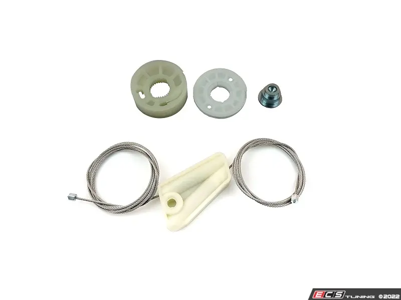

No hardware other then this: 51377201455
https://www.ecstuning.com/Mini-2005-...ow/Regulator/2
Just spray lube it with some of the white lithium grease at all pivots and wear spots.
Update: We now carry a fix kit. One per regulator.
https://www.ecstuning.com/b-bremmen-...377111017~brp/
