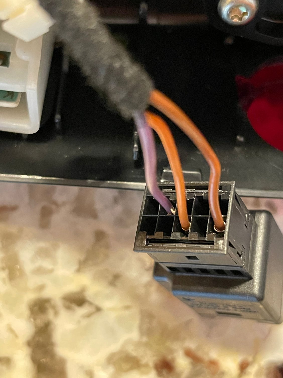

I had the same loose mirror issue in my R52 where it kept dipping pointing downward. I ended up buying a mirror from a 2010 BMW 328I at the junkyard for $23…I pulled the key fob transmitter module from the old mirror and put it in the new mirror, hooked up 2 wires into the molex connector and I now have auto dimming, homelink and a compass. The shape of the mirror is different but I’m ok with that.
