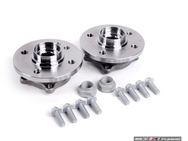

Replaced mine on the R52 Gen1 and R56 Gen2 with the Febi , NTN, and NSK in the past. No issues. They are used as the OEM manufacturer in most cases. Replace the Hex nut at each end and I replaced the bolts also as the old ones were pretty beat up.
I would recommend to do them in pairs. I did one before only to have the other side go rumble down the road. If you do one side at a time. Listen and feel the steering wheel , you can most of the time feel / hear which side is bad in the fronts.
Gen 2 MINI.
http://www.ecstuning.com/Mini-2008-Cooper-R56-S-Coupe-L4_1.6L_N14B16A/Drivetrain/Wheel_Bearings/
Good luck.
