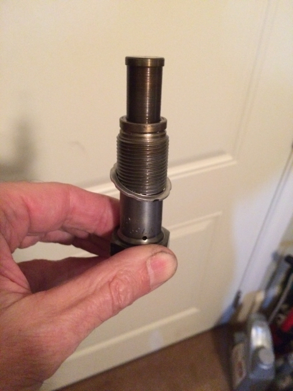

OK thanks, didn't use thread lock so I'll keep an eye on it. I hope that the chain and guides are OK, time will tell. I will be prepared to replace the entire assembly when needed but if I bought a few more years for $37 I will be happy.
Old Mar 8, 2015 | 02:09 PM
York's Avatar
York
Joined: Feb 2015
Posts: 39
The old tensioner didn't have thread lock on it and I did not see that recommendation in my research. Seems like a great idea.

No, with the threads clean and proper torque applied to the tensioner you should not have an issue. Spec on it is 45 ft lbs, we usually add a bit extra to ensure it doesn't back out over time.

The newest tensioner has a little bump on the back of the hex head for the stock size 78mm ~895 part. And then just torque to that set amount. Should be fine.

I installed the x482 tensioner.
