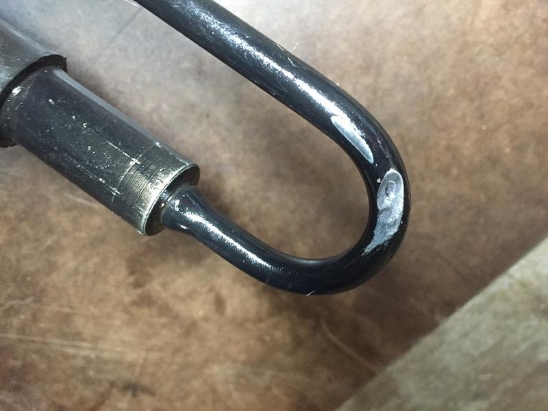

Found the problem! That hose is nearly impossible to get out!!!

Not clear to me which part of the plumbing that is. Please elaborate and provide picture with larger field. What caused that area of rubbing?

It was the high-pressure PS hose. It looks like one of the bolts on the bracket had backed off and was missing, allowing the hose to move around--probably the reason for the rubbing.

The part is right here, seen this happen a time or too. Mostly with that attached rubber bushing mount.
