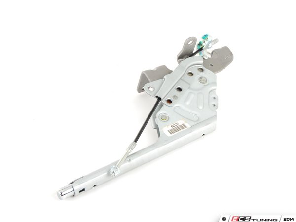

Yea, it maybe jammed internally, I would pop it out and examine the internals. Its it jammed good I would just replace it unless it. It fused riveted together , so you cannot just unbolt the main structure.
Here is the pic and product. Good luck.
34406774814 Handbrake / E Brake Lever
http://www.ecstuning.com/Search/SiteSearch/34406774814/
