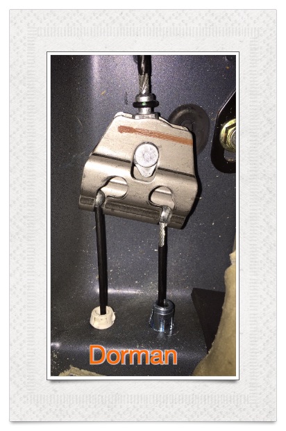

Just finished switching out the mis-matched set of cables from Dorman for MINI parts. I tried replacing the plastic ended cable and using one Dorman and one MINI, but those also weren't the same length, so I put in both the MINI cables. I don't know if it is just a QC problem or Dorman is changing the product and they are mixed in the supply chain or ?
I've attached some photos to show what I had. You can see the two Dorman cables are made very differently and are very different in length. The MINI cables look identical and are very close to the same length.
(update) Meant to add that the clips that hold the cable on are split (you can see in my picture) so if you don't plan on reusing them, it is very easy to pop them off with a screwdriver or two. Probably could even straighten them out and re-use them if you wanted, but the new cables come with new clips, so no need.
No need to drop the exhaust - remove the two screws and two nuts that hold the heat shield on and it will slide/rotate out of the way. With the car on ramps, it is much easier than I feared.
