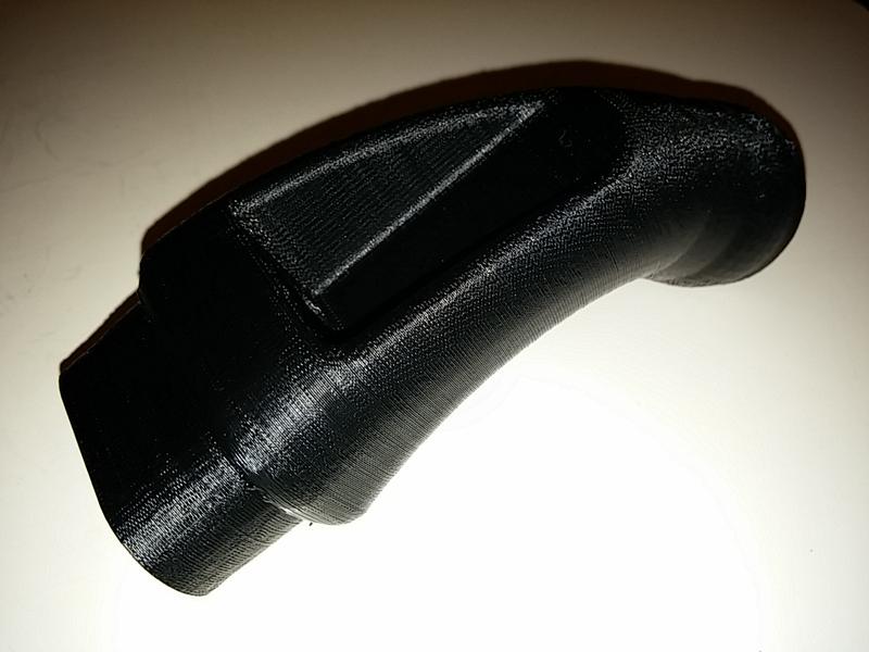

So I have finally created a prototype N14/N18 vacuum adapter and blasting wand - and I need someone to test them. **CANDIDATES HAVE ALREADY BEEN SELECTED 01/15/2015**
The tester will receive:
1) MINI 81292208038 Vacuum adapter ($80 value)
2) MINI 81292208032 Blasting Wand ($30 value)
3) Bimmerhelp modified nipple (used to attach OEM products to Harbor Frieight Tools, see instructions on my DIY available from my website) ($10 value)
4) Bimmerhelp MINI Vacuum adapter (prototype for testing) ($40 value)
5) Bimmerhelp MINI Wand (prototype for testing) ($25 value)

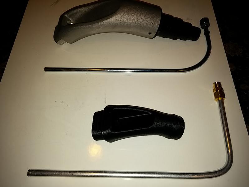

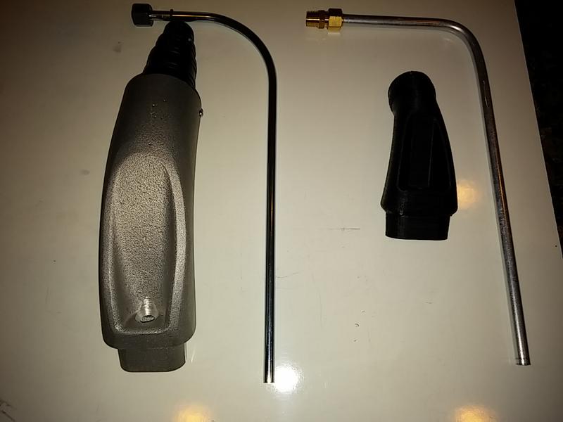

Alright so here's my report on Bimmerhelp's (e90man) vacuum adapter and wand. To put it simply it's absolutely perfect. Vacuum adapter fits perfectly in the port and the wand has just enough movement to move around and get the valves. I actually prefer his over the much more expensive BMW parts. It's simply because his is much smaller. I can do the service without removing the intake manifold. Just pop the manifold back and you have enough room to work. With the BMW adapter it's so big that I had to remove the manifold to get the wand in the port, and that takes extra time. So I say this prototype is good to go!

Originally Posted by two250
I actually prefer his ... simply because his is much smaller.
Couldn't resist - also a MINI reference......
Thanks for your thoughts! I'm very happy to hear that this may be the preferred solution.

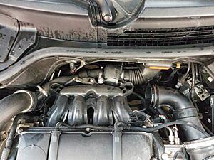

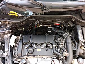

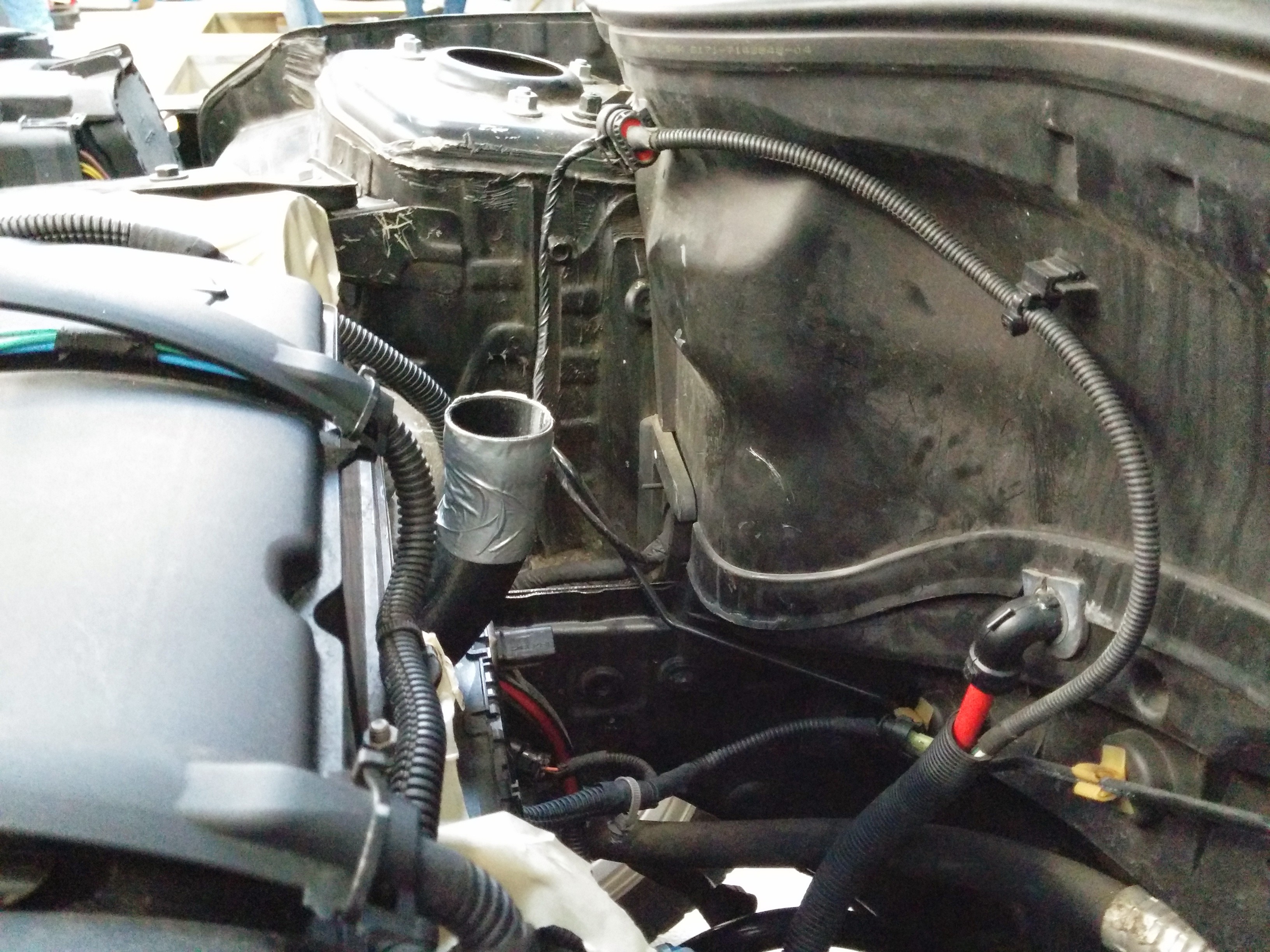

The initial disassembly is quite simple. The only tools required are a T-27 Torx bit, flat head screwdriver, 13mm deep well socket and a 10mm socket. The 10mm bolt is under the intake manifold and can only be accessed by taking off the passenger side wheel. It's cramped in there and irritating to remove.
Here's the car with the airbox removed:
N14/N18 Carbon Buildup TESTER NEEDED-u28mio2.jpg
I have one of the unusual 2011s with the noisemaker. Here's what you're left with after fully removing the intake manifold:
N14/N18 Carbon Buildup TESTER NEEDED-mm5vx09.jpg
We're ready to get to work.

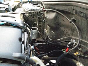

Test fitting the vacuum adapter to the cylinder head, I found that it fits well. It's easily inserted but without any slop, so it stays in place securely. A bit of duct tape was all I needed to fit the adapter to the shop vac. The adapter is also quite small:
N14/N18 Carbon Buildup TESTER NEEDED-nvomzb4.jpg
N14/N18 Carbon Buildup TESTER NEEDED-dt6jies.jpg

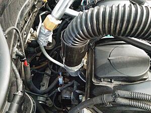

There's tons of room to work. The adapter is about half the size of the BMW version, and it's a big advantage when maneuvering the wand around. Here's my last minute, custom wand setup that probably wasn't necessary:
N14/N18 Carbon Buildup TESTER NEEDED-5uasyzq.jpg
One suggestion I can make concerns the length of the wand. Both e90man's and the BMW wand could stand to be about 2 inches shorter. I was having a hard time cleaning some spots near the top of the head because the gun was hitting the firewall panel, limiting its range of motion. Once I cut two inches off, I could easily clean the top and still touch the valves.
N14/N18 Carbon Buildup TESTER NEEDED-hbs7k5z.jpg

E90man's vacuum adapter is superior to the OEM version. It works flawlessly and allows more maneuvering while cleaning.
His wand attaches to a 1/4NPT thread securely, unlike the OEM version. Both could stand to be 2 inches shorter, a quick garage fix.
