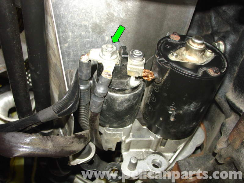

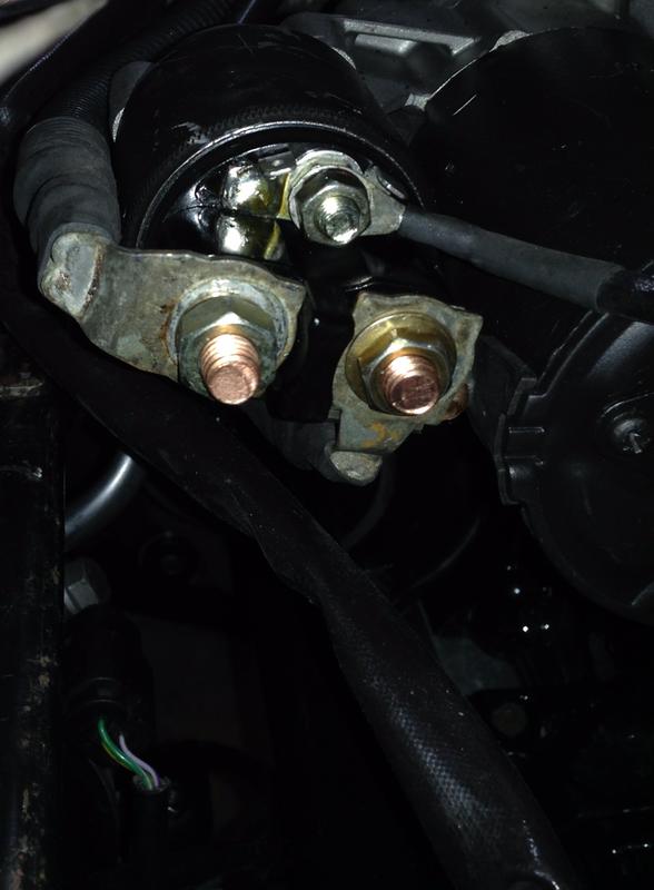

When I was installing the engine, I managed to attach the B+ lead going to the rear to the correct post on the starter solenoid and the B+ cable heading to the alternator to the _other_ post of the solenoid (which is wrong, they go to the same terminal). Of course, this means the alternator was not in the charging circuit.... or at least was dumping current through the solenoid coil. I'm still surprised it started and run and didn't blow a fuse or throw a code, but it didn't.

you have a picture?

The right way to connect the battery cables at the starter first (image with green arrow), I found this image on the PelicanParts website (Thanks!) for DIY clutch replacement.
The wrong way next (which I have since corrected).
