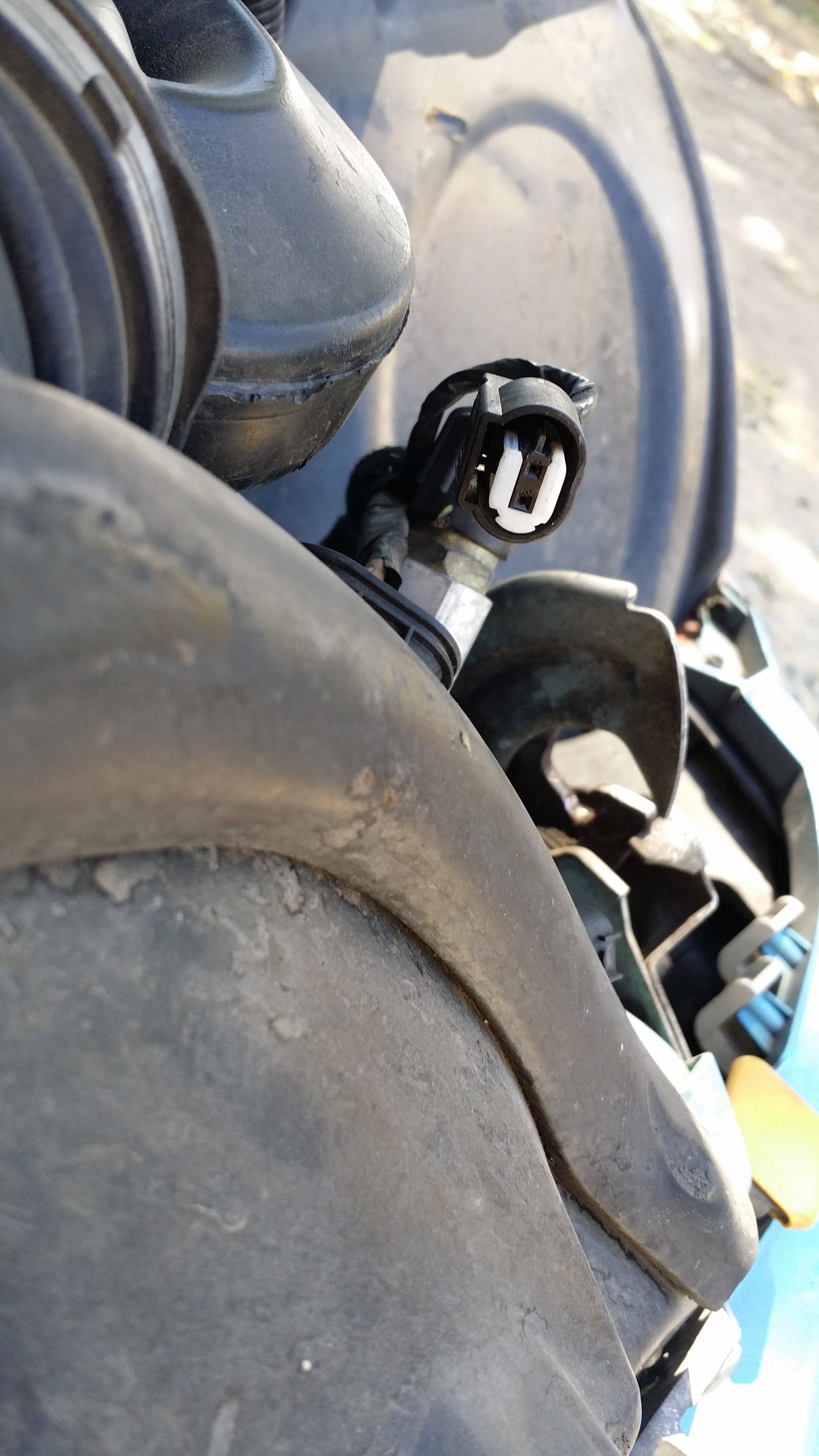

Sorry, been a while had some stuff come up. In any case, here's a pic of my 2 wire connector, it's the oval one. Is this supposed to be a different connector these days? Or was this part of a recall that didn't happen on my Mini?

pretty sure (from the shape of the plug) that is the plug that powers the PS cooling fan...
http://www.waymotorworks.com/oem-pow...ering-fan.html
If the wiring change was done...this plug is either CUT off...of just left hanging....
the change was part of a campaign, not recall...basically if you had an issue while under warranty, or just had a good dealer, they wold change the wiring to match the 2005+ PRODUCTION cars...
Not sure what you having going on...but the fan runs VERY little unless the car has been run pretty hard or it is a hot day....or the ac is on...
remember, the cast iron block is a BIG heatsink....

The radiator fan has a single wire with 2 connectors that come off it, 1 that's the now unplugged 2 wire connector, the other is the 4 plug/3 wire connector. The ps fan works independent of the other 2 being plugged in/unplugged.
