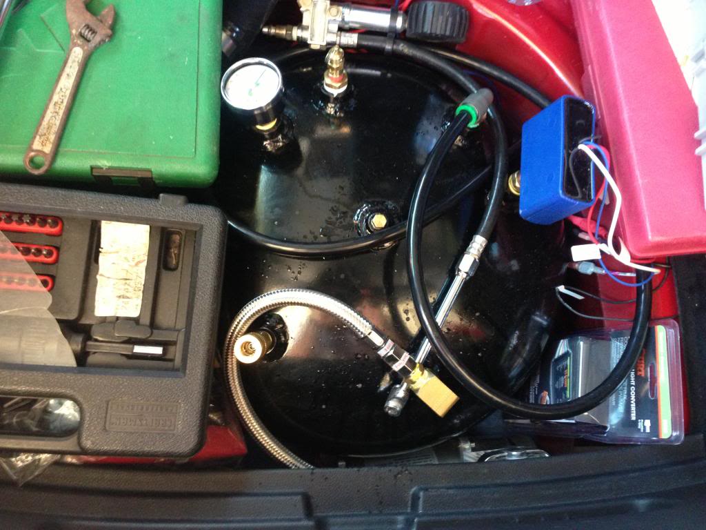

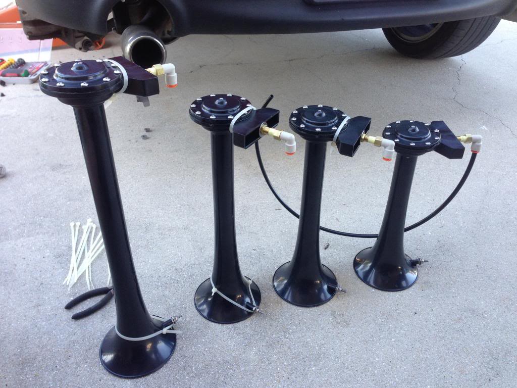

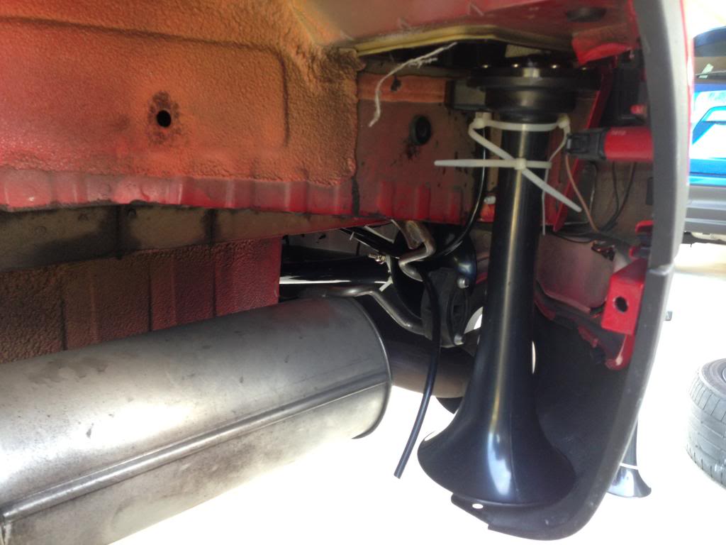

....might be a good excuse to upgrade to a airhorn...aka like a truck or train...can be quite interesting on a car as small as a mini!!

or Air trumpet kit if you really want to be loud.
http://www.ecstuning.com/Search/SiteSearch/UN6627400/
