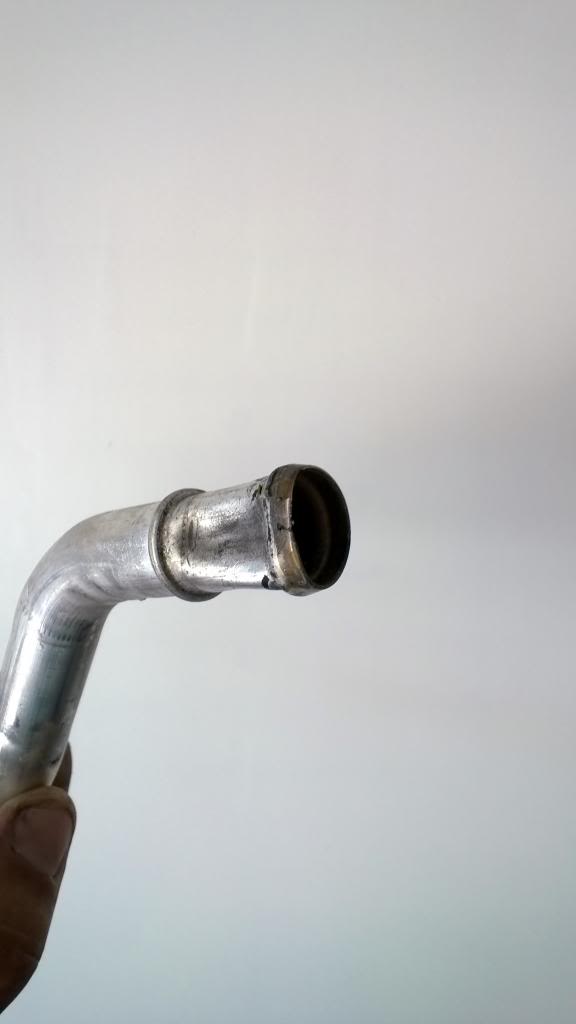

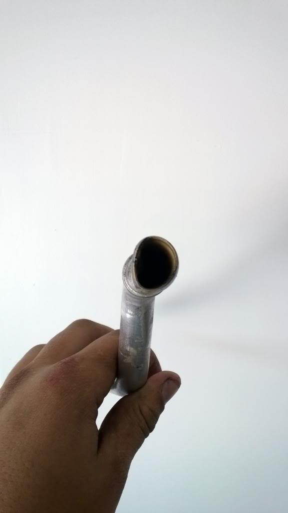

Ok, so its taken longer then expected to get a chance to fix everything, but I finally got around to fixing the coolant leak in my car. The issue was one of the metal lines starting at the firewall and going into the heater core.
