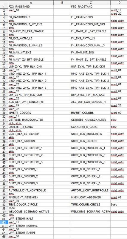

I've been going through Mini's website for Germany trying to get Mini's wording for the ambient lighting in German. This could help me locate the setting. I'm guessing the setting will have "LED" in the line. If anyone here with a 2013 or 2014 has access to NCSExpert and can read their FRM module, I will compare it to my settings. Just send me your TRC file. Some possible settings are in:
ZUWACHS_TASTVERH_FLC_LED which translates to "Growth duty cycle" don't know what FLC is. It can also translate to "Incremental pulse duty". Mine is set to: wert_01
LED_LICHTFUNKTION = LED Light Function. Mine is nicht_aktiv
MIN_TASTVERH_BEL_FLC_LED May work together with the first setting. Also set to: wert_01
I will compare every line in the file and note every difference I find (it's only 24K). I really can't believe this feature would be a hardware difference. It is probably a different wert or aktiv/nicht_aktiv setting.
You can have my trc file. At the very end there is a setting:
WELCOME_SCENARIO_ACTIVE
aktiv
Here's my file:

TIME_COLOR_CIRCLE
3sec
aktiv
Here's my file:
FZG_RADSTAND
wert_19
wert_20
FH_PANIKMODUS
nicht_aktiv
FH_PANIKMODUS_MIT_EKS
nicht_aktiv
FH_MAUT_ZU_FAT_ENABLE
nicht_aktiv
FH_EKS_AKTIV_L3
nicht_aktiv
FH_PANIKMODUS_MAN_L3
nicht_aktiv
FH_MAN_MIT_EKS
nicht_aktiv
FH_MAUT_ZU_BFT_ENABLE
nicht_aktiv
UNP_ZYKL_TIPP_BLK_CKM
wert_01
MIND_ANZ_ZYKL_TIPP_BLK_1
wert_01
MIND_ANZ_ZYKL_TIPP_BLK_2
wert_01
MIND_ANZ_ZYKL_TIPP_BLK_3
wert_01
DEF_ZYKL_TIPP_BLK_CKM
wert_01
ALC_DEF_LWR_SENSOR_HI
wert_23
INVERT_COLORS
wert_02
GETRIEBE_HANDSCHALTER
aktiv
SCHALTER_R_GANG
aktiv
QUITT_BLK_ENTSICHERN
nicht_aktiv
QUITT_BLK_SICHERN
nicht_aktiv
QUITT_BLK_ENTSICHERN_1
nicht_aktiv
QUITT_BLK_ENTSICHERN_2
nicht_aktiv
QUITT_BLK_ENTSICHERN_3
nicht_aktiv
QUITT_BLK_SICHERN_1
nicht_aktiv
QUITT_BLK_SICHERN_2
nicht_aktiv
QUITT_BLK_SICHERN_3
nicht_aktiv
AUTOM_LICHT_KONTROLLE
nicht_aktiv
INNENLICHT_ABSENKEN
wert_06
TIME_COLOR_CIRCLE
5sec
nicht_aktiv
I also don't have the following three lines from your trc:
LWR_STROM_HALT
wert_01
LWR_STROM_NORMAL
wert_06
LWR_STROM_RAMPE
wert_06
My new guess on possible settings are
INVERT_COLORS
wert_02 yours wert_01
nicht_aktiv yours aktiv
In the next few days I will see if I can get mine to cycle. To tell you the truth, I haven't even noticed my accent lighting on when I unlock or open the doors. I do have them set to the lowest level though. I replaced all interior lights with LEDs and those are so bright, that that's all I see.
That's when they are in disco mode.
8/2010+
8/2010+
When I set mine to aktiv, I locked, unlocked then opened my door. At that point it did one cycle through stopping at my original color. Sounds like your exact results. Then I set it back to nicht_aktiv because my interior LEDs make it unnecessary. Hope I helped.
