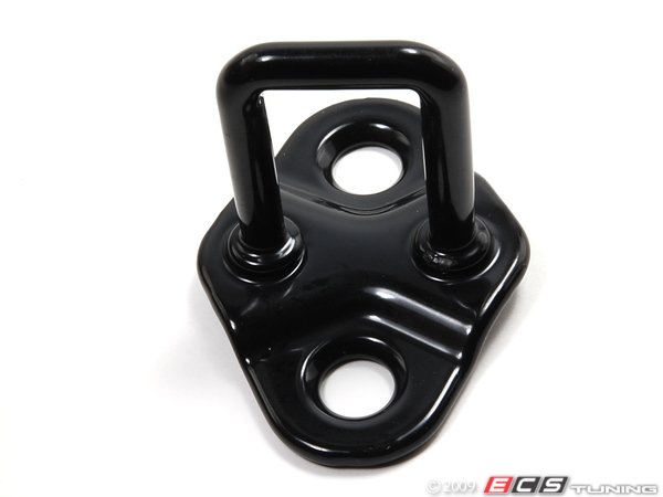

Also make sure the hook catch (trunk striker latch ) in lined up to hit the lock mechanism correctly.
#9 in the diagram Trunk Striker Latch part # 51247154735
