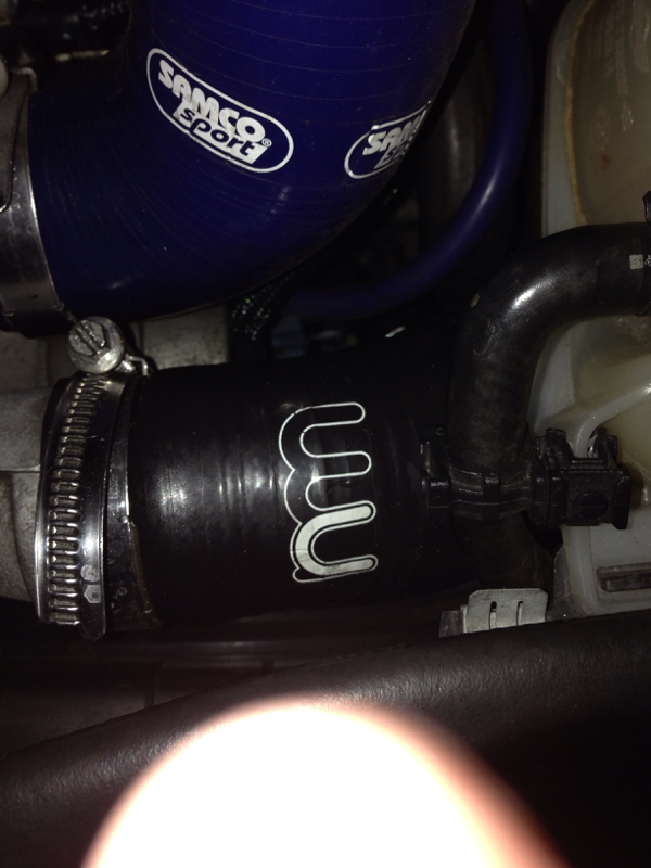

That could possibly explain the inlet intake and outlet but how would that explain the air discharge charge pipe. But not the air charge. As the mist is on the opposite side. The mist starts at where the plastic hard pipe begins to right before the silicone elbow. The silicone also has been stretched over it, so where you see the clamp is the end of the plastic tubing.
I've attached a few pictures the, discharge pipe has a little bit of the mist on it toward the turbo outlet, but the other doesn't ill get better pics tomorrow.

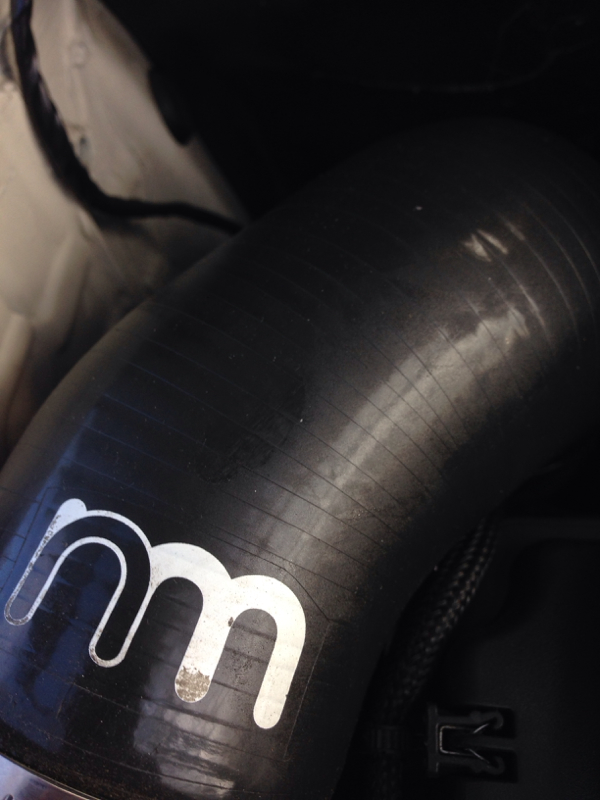

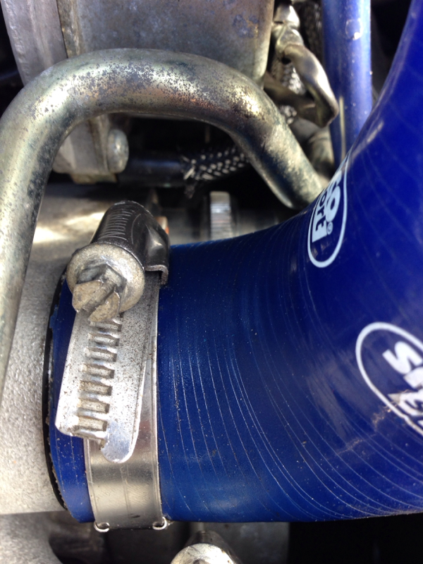

I'm gonna try that tonight. In the mean time here are the pictures of an early morning.

Looks like normal road dirt to me. Not a lot of it either. No idea why you are seeing it more there other than you just put a new accessory on your toy and your eyes are landing there first. I notice there is some corrosion on the metal in your second pic. By chance are you driving on salted roads? Not sure where you live, but it is snow season and slush holds a lot of dirty yucks. I'd call NM, maybe there is a break in period for their materials, but that would be weird.
That could make scenes the discharge is newer, last couple months, but if it's road dirt why would it only be popping up when the cars sitting

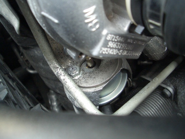

I took a couple photos of what looks like spray on my turbo. It's mostly on and around the vacuum pot and the oil feed pipe. Bizarre. Can't see where it's coming from.
