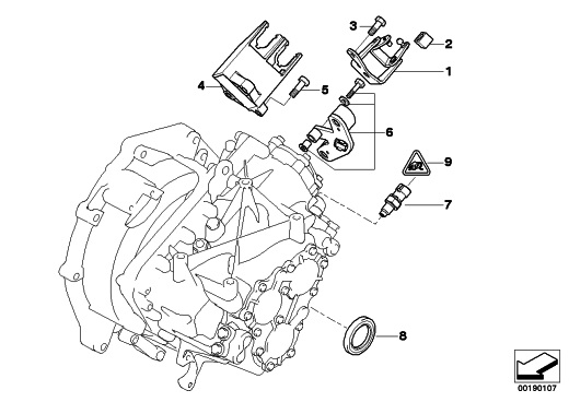

It's # 7 on the diagram

07 23117527716 BACKUP LIGHT SWITCH 0.02 1 $17.27
Yep that should be it, I don't know if you can reach it from the FL wheel or taking the airbox out but the airbox will take longer
Check out figure # 16 on the Pelican parts article
http://www.pelicanparts.com/techarti...eplacement.htm

That's the part, here is another picture.
Back Up Light Switch # 7 in that diagram above.
