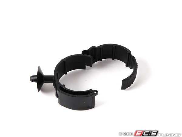

Its the little hose clamp. Mine where broken and once I replaced them they held in better. If you do have the GP2 belly pan kits we have it helps hold it in place also, a little extra insurance in-case the clips snap again.
#11 http://www.ecstuning.com/Search/SiteSearch/11722756407/
And here is the GP2 Belly Pan kit. Which we include the extra hardware.
https://www.northamericanmotoring.co...-in-stock.html
Sweet, I'm putting on my new hose kit and was struggling to find the right image that showed all the hoses! Death to the original fasteners and stupid pinch clamps!
