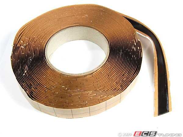

Yea, the joey mod or for people creating there own special factory headlight mod. We have butyl tape in this form . If you need it a little thicker you can roll it.
Butyl Tape
