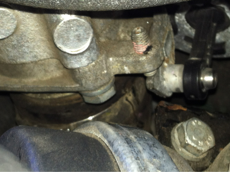

Not what I was expecting,... This is the BPV when the car is off, it rests against the stop with the pushrod from the vacuum diaphragm extended.
I started the car, and just parked at idle, the vacuum diaphragm pulls it all the way in the other direction.
I don't have an assistant here to operate the throttle while I watch the valve move.
At this point I'm thinking maybe the thing to do is pull the vacuum line off the diaphragm and cap it with a small bolt or something.

I initially thought the same thing and zip tied it the wrong way (opposite from where it sits with the car off) and I got no boost lol. Zip tie it the way it sits when the car is off and that will build boost. Unfortunately I didn't gain any psi so I don't think its the bpv for me :-(
