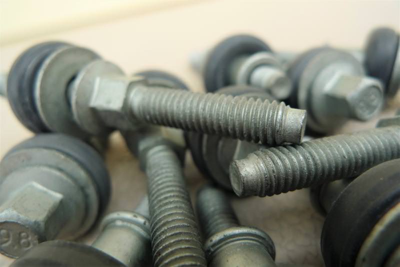

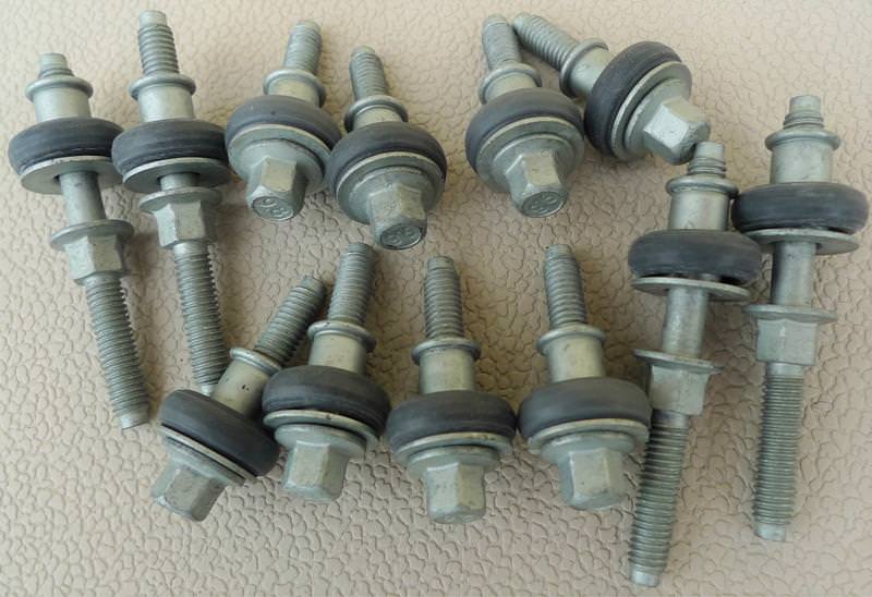

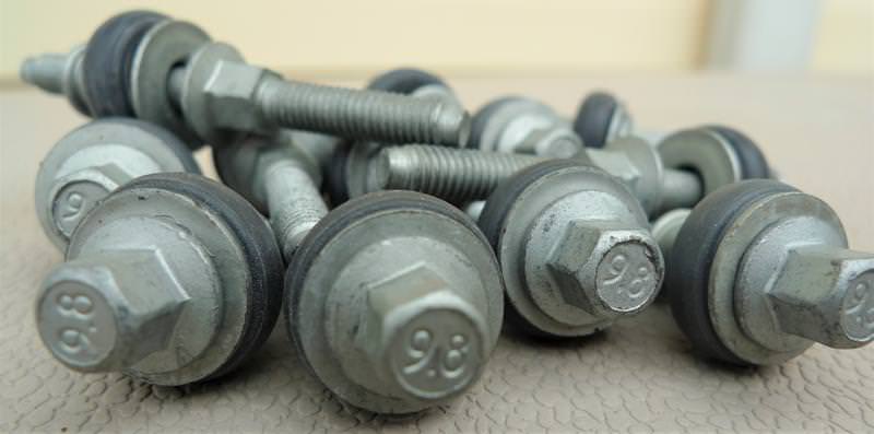

Well, the mailcarrier just dropped off my new bolts. I was expecting the longer ones to be black but they're not.
The coating appears to be zinc flake?
Like Dacromet or something?
This is my first "modern" car, I'm coming from mid 80's Saabs --- I'm not used to such shoddy fasteners but I reckon it's a universal cost-saving thing in the hypermodern automotive industrial world?

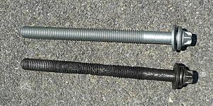

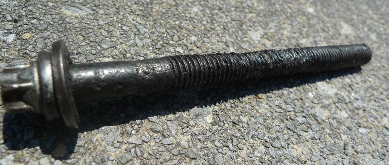

I'm so glad I researched and took note that modern bolts can suffer catastrophic corrosion and are pretty much "one use" only, like if I hadn't have got a new motormount bolt before I changed mine out it'd been a pain-in-the-arrrse because the one I removed was super scary:
So, this is the brave new world, cheap as chips and brittle as sheeit?
