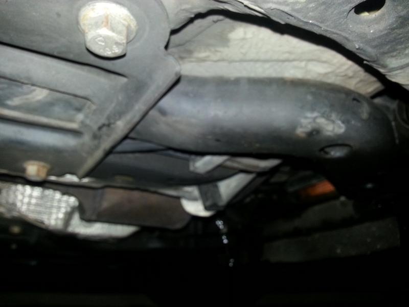

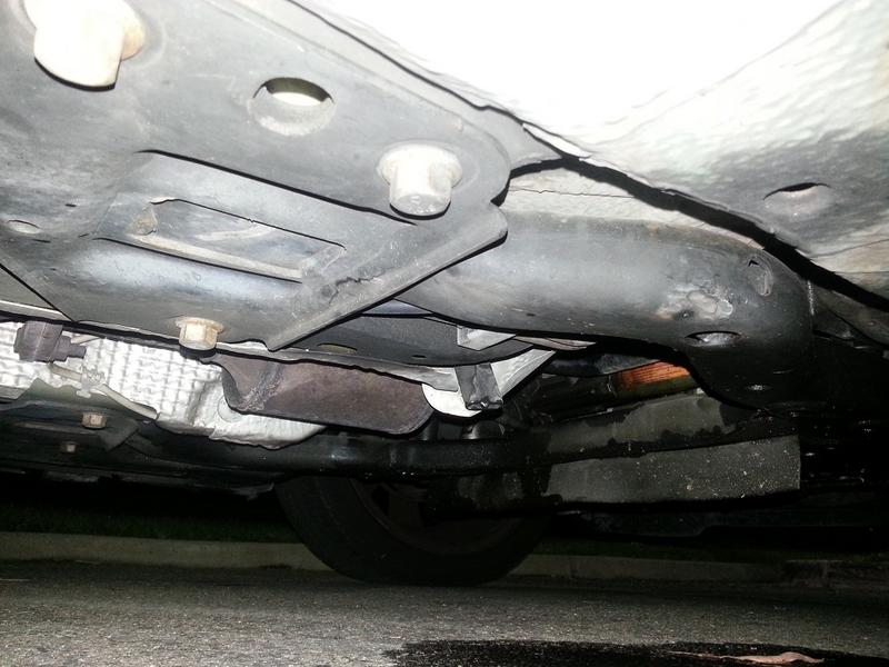

2004 Mini Cooper, base model, 84k miles.
I just topped off the coolant and bled the system, but on the test drive, I pop out and notice this leak. I don't have jack stands, so I'm not in a good spot to really dig in and figure out what's happening, but I did manage to snap two pictures. Can anyone identify what hose that is which is dripping coolant? It looks strange to me - it doesn't appear to be broken, the lines are much too smooth, it's simply... hanging there. It doesn't look right, that's for sure. That was my first hint - second was that it's dripping coolant, duh.
This is located in the center of the car, as far as left-right goes, and towards the back of the engine. (Edit: Clarification, it is far enough back that I can not clearly see it through the engine bay. I placed a light source under the car just next to the puddle - when I try to view that light through the engine bay, it is too far back to see. I can see the light, but I can't put eyes on the source. This is probably self-evident from the photo, as it is behind the front wheels.
Anyone please, what is this that is dripping coolant from my engine and scaring the bejeesus out of me please?

Wow is it really? Oy, thanks for putting my mind at ease about that, but that complicates things since at the end of my test drive last night, it was overheating a bit. Siiiiiigh. Gotta figure out why it's overheating.
